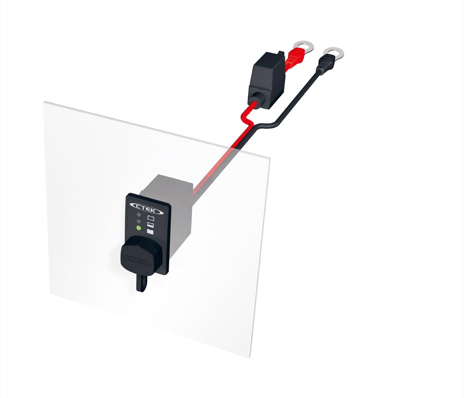

Not sure why no one has mentioned this but for the cleanest, most professional and easiest install, I recommend the comfort indicator.
It's a quick jack installed in the trunk area and provides a 3 level indicator light to tell you if you need to connect the car to the tender. I love it.
CTEK Comfort LED Indicators
Amazon.com: CTEK (56-380) Comfort Indicator Panel M8 for Top Post Batteries: Car Electronics Amazon.com: CTEK (56-380) Comfort Indicator Panel M8 for Top Post Batteries: Car Electronics

That is a very nice indicator cable, personally it would be no use for my situation. I hook up every week and there has never been a time that it didn't need a charge, it doesn't matter how low it is I weekly top-off the charge to hopefully extend the battery life.
Since I have an older Schumacher maintainer that only has the clamp style connection, so I spliced in my own quick connect wires bought on Amazon:
Amazon.com: Battery Tender 081-0069-6 Ring Terminal Harness with Black Fused 2-Pin Quick Disconnect Plug: Automotive Amazon.com: Battery Tender 081-0069-6 Ring Terminal Harness with Black Fused 2-Pin Quick Disconnect Plug: Automotive
I bought four, one each for the car, motorcycle, and jetski. The last one I permanently attached to the maintainer clips (backwards so the polarity will be correct when attaching).
I have the in-line one with the cigarette plug adapter.
Great accessory for the CTEK, but wire harness is quite short and I did not want to install in the trunk and have to open the trunk all the time to see the indicator nor rewire the indicator for a longer connection. In addition, this accessory would be good if you cannot see the CTEK unit itself.
Every CTEK I have has it's own LED Indicator lights on the unit. I can open the door from the house to garage and see the row of LED's on the unit. I always know what level of charging or maintaining the CTEK is in.
In the image below it is clear to see that the battery is at max level step#7. LED #8 won't light up until the car sits for 10 days. Then the CTEK goes to level/step 8 with a pulse charge to maintain the battery at top levels.
Click the image to enlarge.
