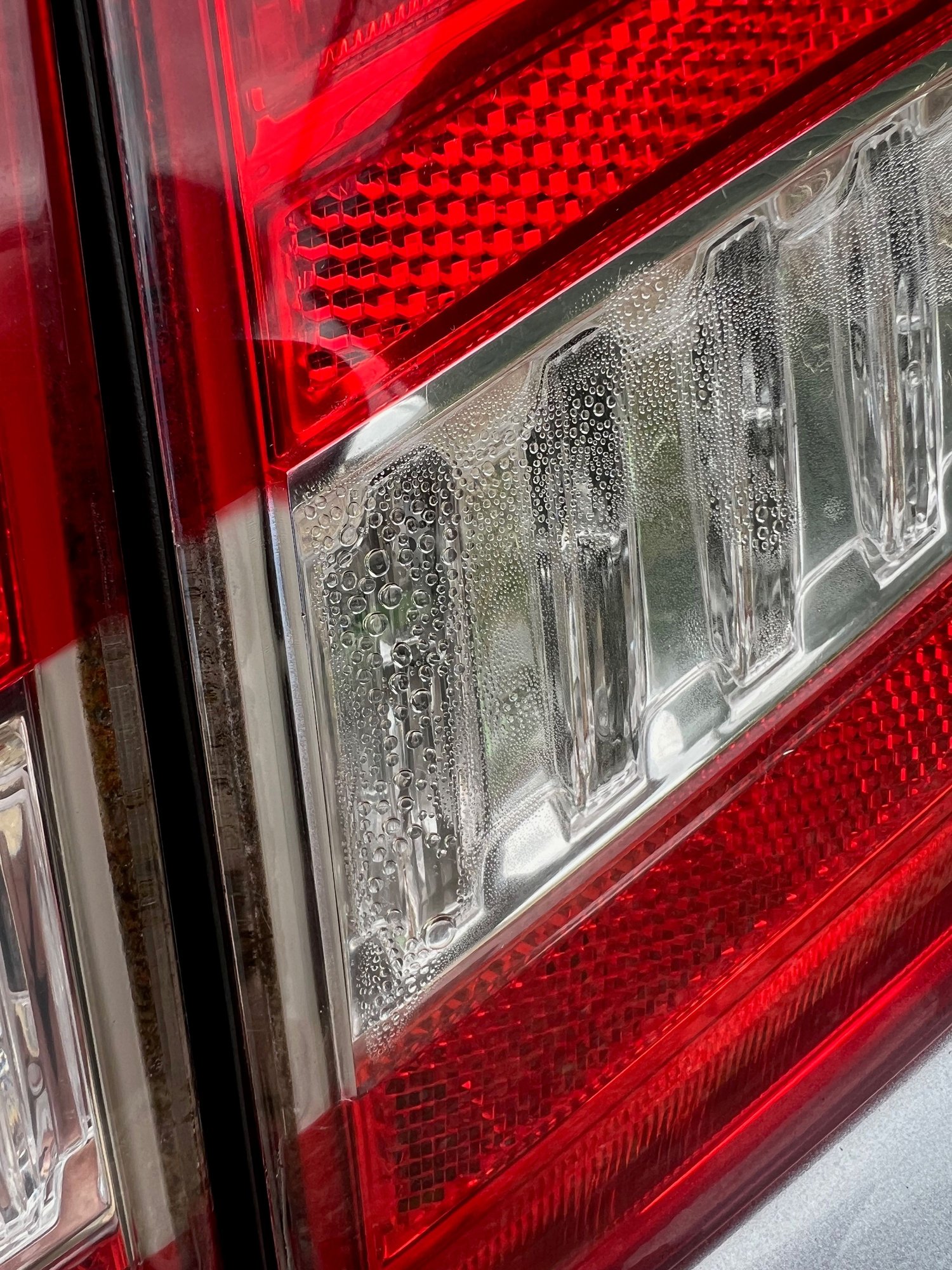

Is this (attached) the "usual water ingress issue", and should I be worried about it?

Yep, that looks about standard I'm afraid. Apparently, the seals on the unit are a bit suspect and ultimately fail after time. If the LED's are currently all working, you may be able to remove the unit, dry it out with a heat gun (carefully!) and apply silicone to the edges to try and bolster the seals. However, if there are LED's out, then you'll need a repair or replacement unit. Personally, I decided against a second-hand unit (which seem to be offered for around £300) due to the chances of paying for the same problem. Hope this helps.
