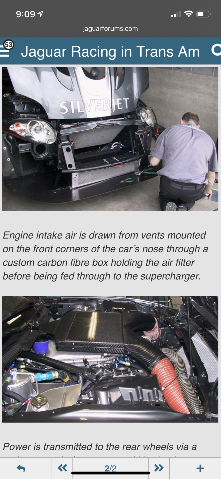

Originally Posted by gkubrak
Is there really that much clearance between the S/C and hood for a 2-3" pipe like that?
They dropped the entire drive train 4 inches to lower the center of gravity.

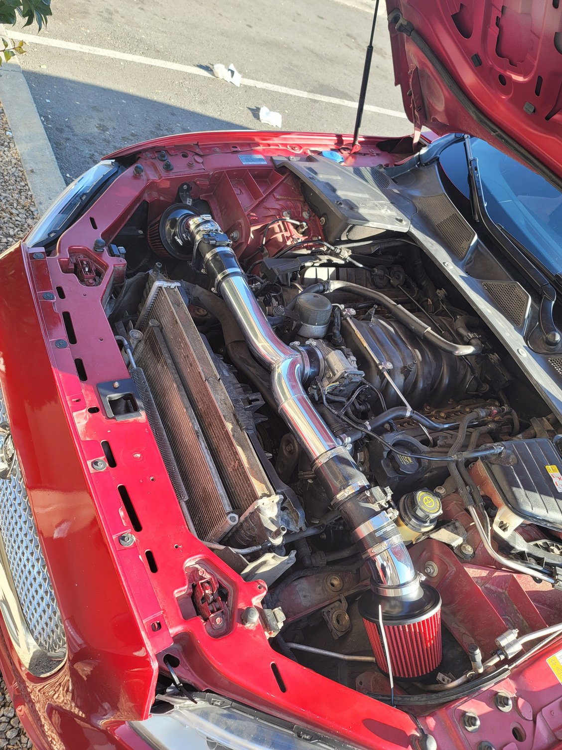

Originally Posted by jahummer
I wonder what those little tubes on both sides of the intake tubes are.. any ideas ? Also what is the arrow pointing to?

Old Dec 23, 2020 | 08:33 PM
fxdwg's Avatar
Joined: Oct 2020
Posts: 184
Likes: 136
From: Oklahoma, USA
The tubes are remote shock reservoirs.
Old Dec 23, 2020 | 09:35 PM
jahummer's Avatar
Joined: Dec 2008
Posts: 6,460
Likes: 2,583
Beat me to it...used for multi-way adjustable coil-overs, if you look closely they are not attached to the intakes.
Old Dec 23, 2020 | 11:42 PM
AlexJag's Avatar
Sponsor
Joined: Apr 2016
Posts: 1,344
Likes: 453
From: San Diego CA
Hmm interesting .. I wonder what they did with the stock oil baffle PCV system.

Old Dec 23, 2020 | 11:55 PM
mhminnich's Avatar
Joined: Oct 2014
Posts: 896
Likes: 706
From: Arlington, Texas
My guess on the arrow is the drive for a dry sump oil pump.

Old Dec 24, 2020 | 09:10 AM
  #28
jahummer's Avatar
Joined: Dec 2008
Posts: 6,460
Likes: 2,583
Yes, dry sump and no PCV.
