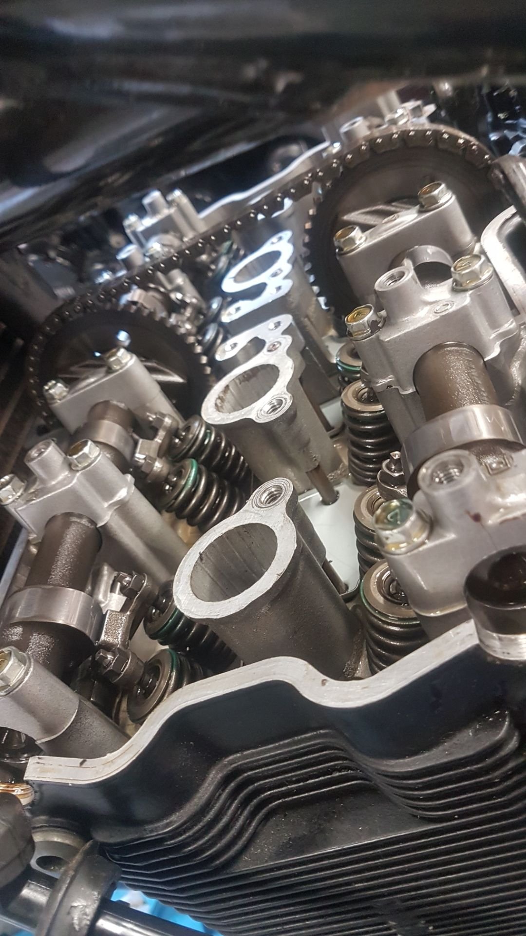

Then you haven't seen the damage it causes first hand...I have. There's a reason none of my non-racing engines have ever had any wear of anything - and its all linked to oil - and on vehicles that probably do less than a hundred miles a year. I'd rather abuse a battery than an engine, no contest, but that's just me. Won't drip dry in an hour, more like up to 6 months. However...each to their own.
I have to do my own work on the engines I preserve, and that's probably the difference
This is what the inside of a 20 yr old engine looks like with a decent mileage when the iconsition and distribution of oil is your priority
