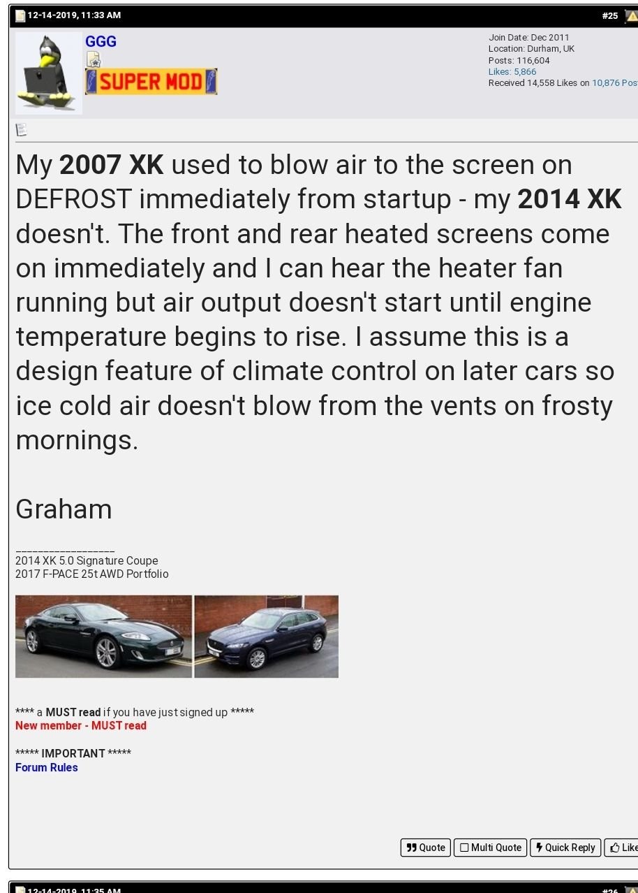

Your Automatic Climate Control should eliminate the foggy windows. You'll have to wait for your engine to warm up before it can blow warm air out of the vents.
See this old thread from 2013:
https://www.jaguarforums.com/forum/x...-108336/page2/

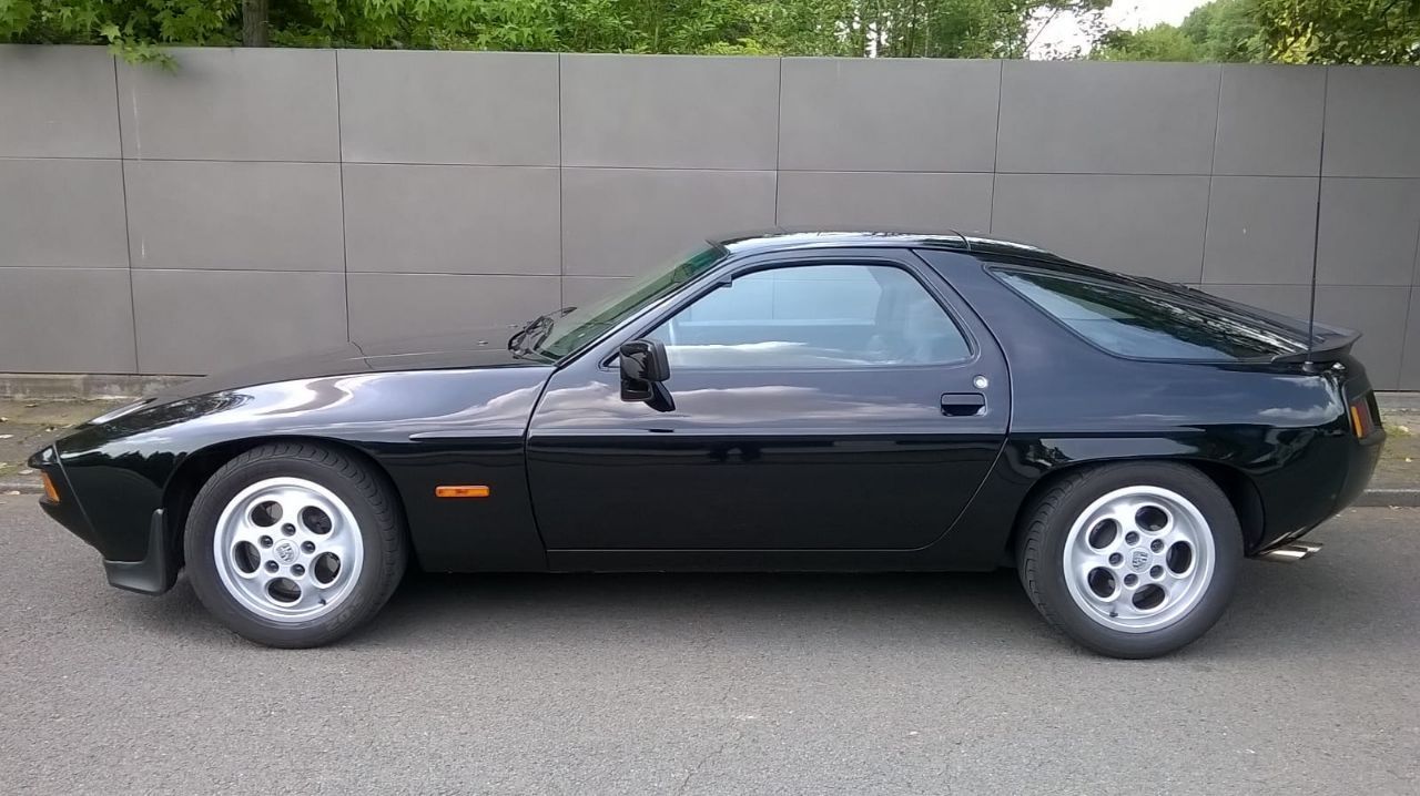

You are welcome, Tony. By the way: XK and 928 goes very well together. ;-) My early 928S with manual 5-Speed:
