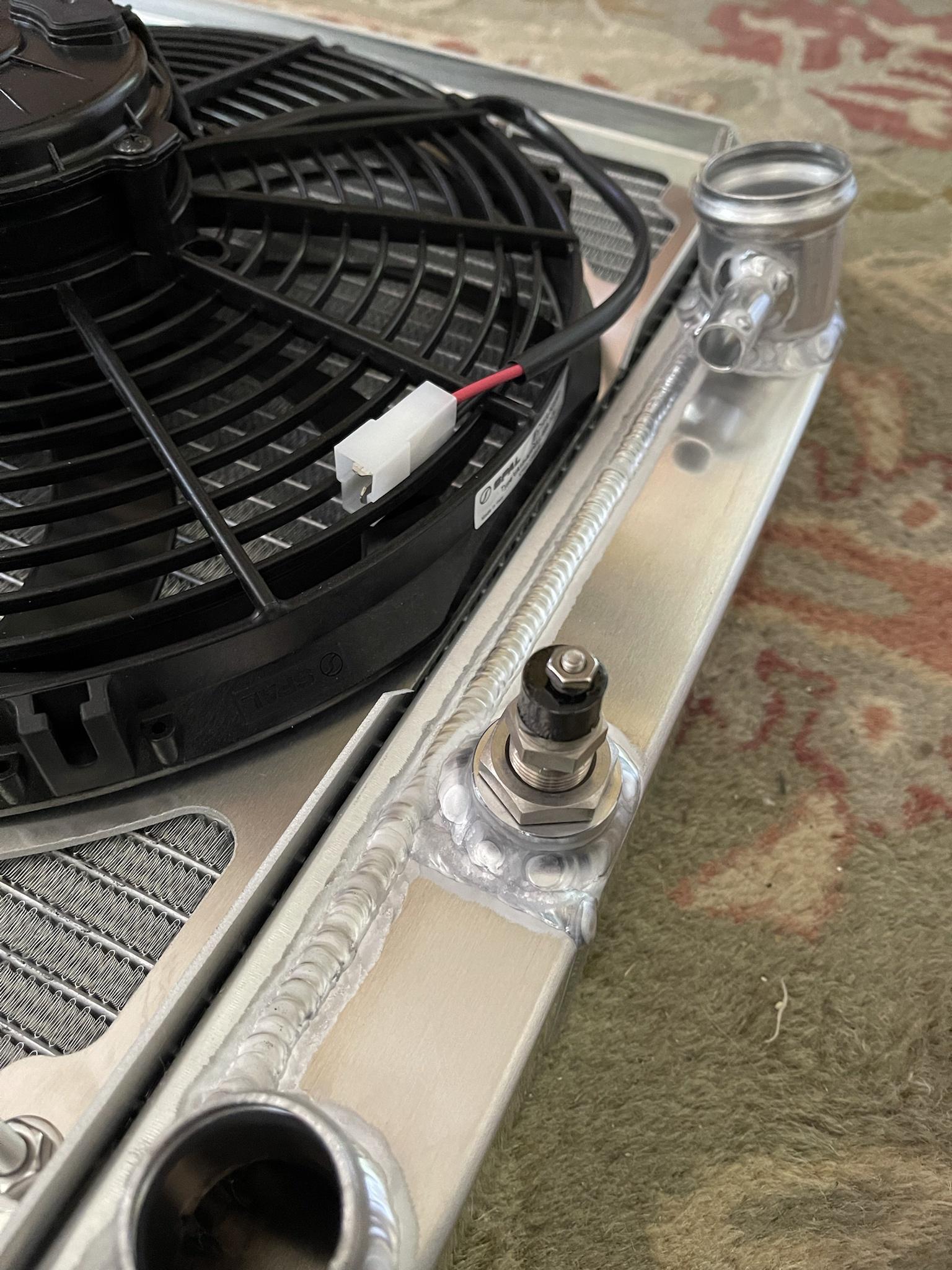

That's actually good information. I had assumed there was a switch port in the bottom part of the radiator based on pictures, but wasn't certain. Thank you for sharing!

I’ll take a picture of the radiator when I get home this afternoon and post it.

The fan switch is in the waterpump housing

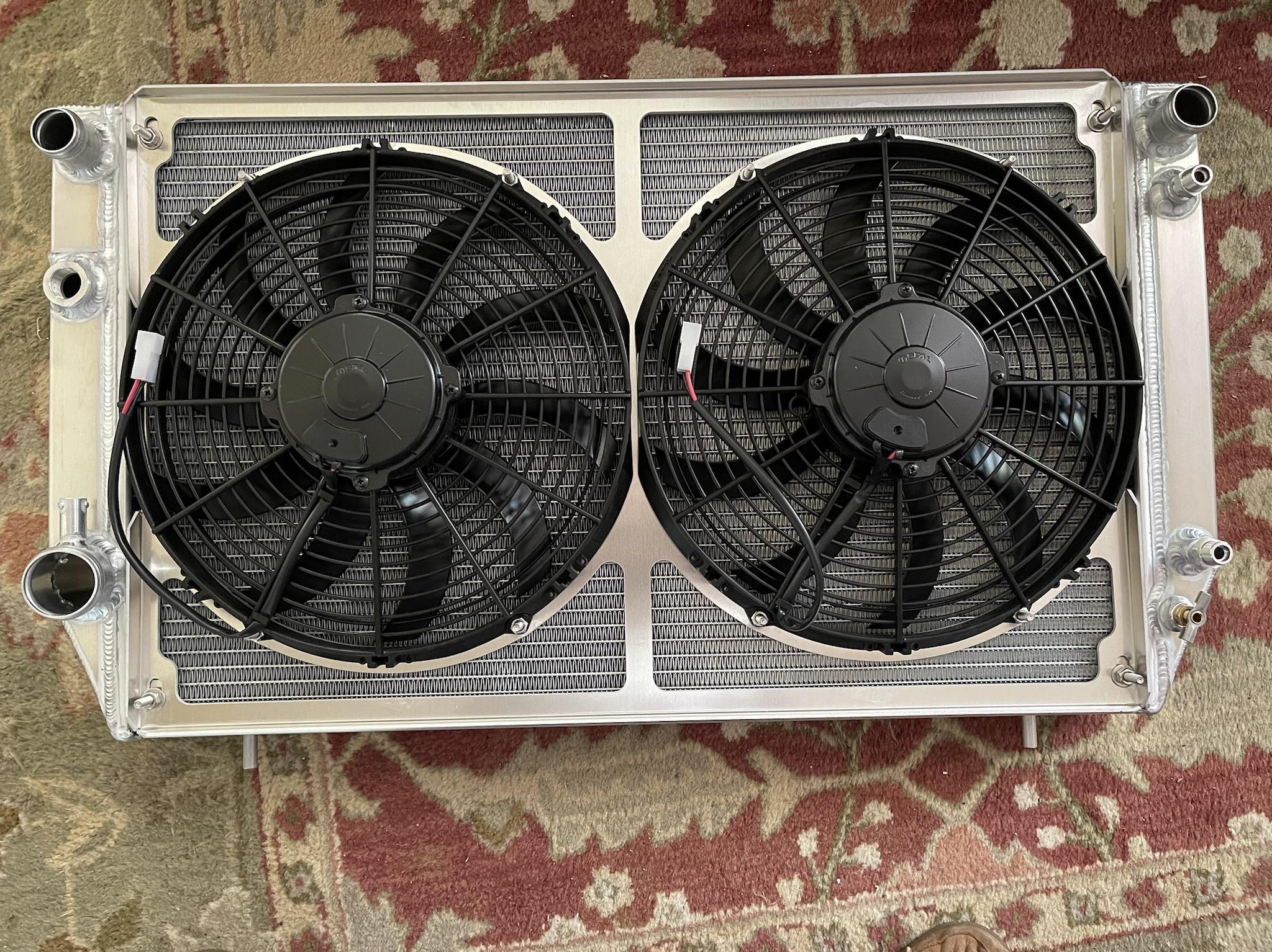

Little later than I promised, but here are the pictures of my Wizard Cooling radiator and fans. I went with the "High Performance" fans, they're bigger (deeper really) but provide the most cooling. There is a threaded hole in the outlet side of the radiator for the temperature sensor. It is high up, but bellow the plate that separates the left hand inlet from the outlet. So it will measure the outlet temperature. There is an adaptor plug for the temperature sensor included. The transmission cooler connections are on the right hand side of the radiator. They're optional, so if your car has a manual transmission you can save $30 by leaving them off.

Thank you for sharing! I ordered mine last night - can't wait for it to get here.

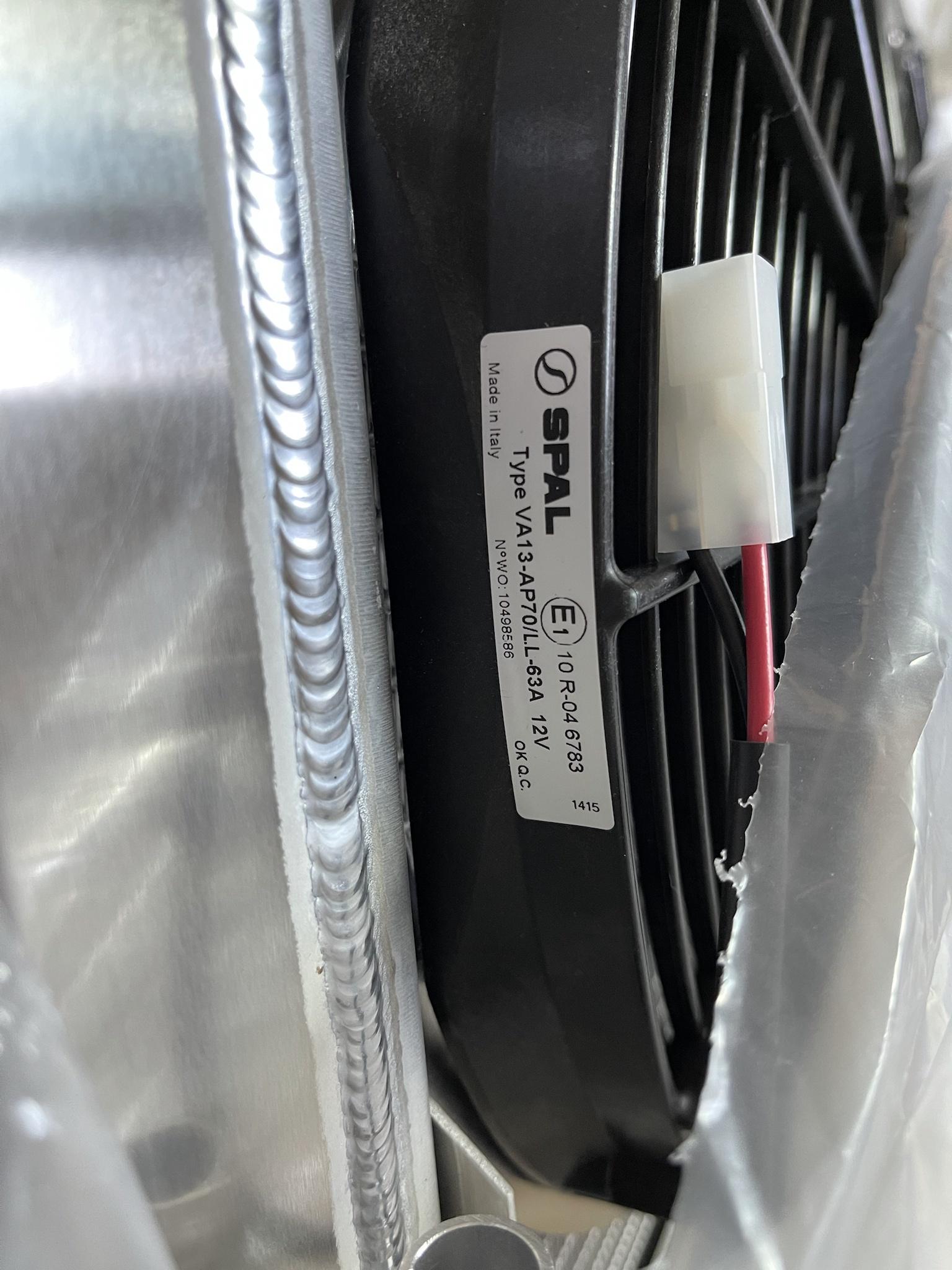

Would you mind taking a picture of the model number on one of the fans? I'm curious as to which one they use in the high performance configuration.

Here you go! I don't think they stock XJ-S radiators. It was 2 1/2 weeks between when I ordered mine and when it shipped. Probably 3 weeks total until it arrived.

Thank you. That fan is rated at 1,777 CFM and 19.5 amps. I bet two of those move a lot of air!

That radiator is a thing of beauty........... very nice!

Very nice looking setup for sure. Have you had it installed yet ? I’m still torn a bit but I think I am just going to refresh the original fan and associated parts and keep it in place.
I like the idea of cleaning up the space up there but even the electric fans seem to take up most of the room between the radiator and motor.
