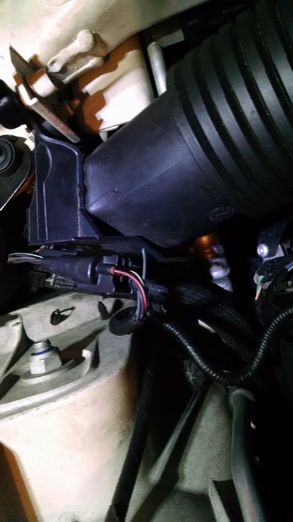

I start poking around and can't find the MAF so off to the service manual... Find out there are 2, mounted in each air cleaner box. While I was trying to find the air box, I noticed this on the driver side (see the green wire broke loose):
This harness goes down towards the air cleaner box so I assume this was part (or all) of the problem. I managed to solder the wire back on (not sure how long it will last) and clear the code.

I'll also mention that this wiring harness on both sides were broken loose from the anchor point. The friction push pins were worn out. The vibrations must have been what broke the wire. I zip tied each harness to the mounting point for the time being.
