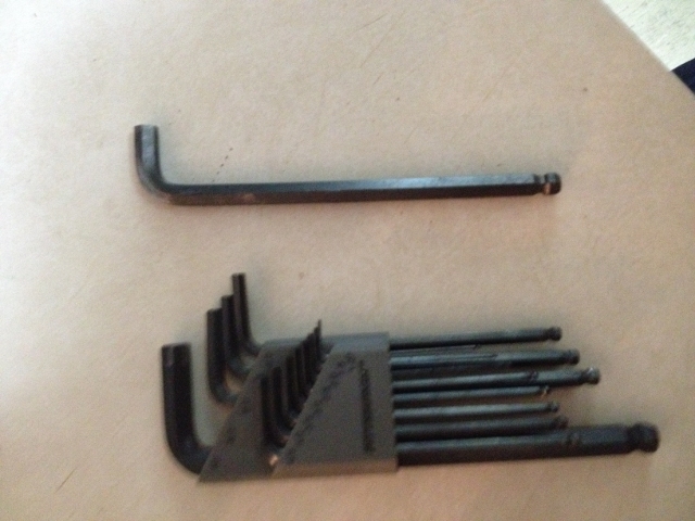

Another easy method of getting the fill plug out is to grind some of the end off an 8mm allen wrench. Give it a wrap with a deadblow hammer, or use a small cheater if too tight to get it loose by hand. Easy peasy.

I was planning on zip cutting down an 8 mm hex wrench.
