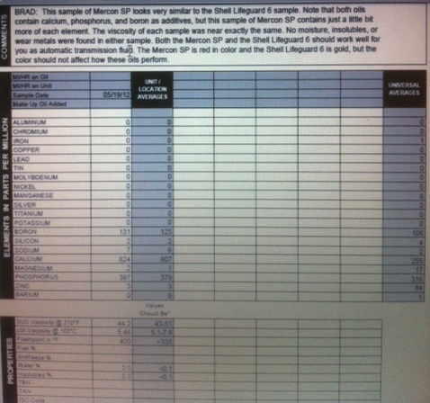

I've seen the Blackstone analysis of LG6 and Mercon SP and they are the same. Shell internal numbers shows the base the same. The additives are identical between the two, but the most important component, both are Shell ATF M-1375.4, made by Shell, one in Europe, one in the US, which is the specified fluid. Mercon SP is not compatible for those who use LG8, which is synthetic.

Don, I'll have to address this in two parts due to time today. When you go back to Shell's internal numbers, you'll find the base stock is used in a number of various lubricants under brand specific usage, and was researched at Shell's global site, I'll have to go back the trail, but the same stock is identified. Saw it for myself. The FIR number listed in your Ford MSDS is actually for Custom Bright Metal Cleaner. (chrome polish) The MSDS listed for ZF is actually naphthalic fluid used in the medical field. (baby-oil) I know it gets confusing really quick.
Here is the Blackstone images...
Attached Thumbnails Another Transmission Fluid Thread-lg6%2520new.jpg   Another Transmission Fluid Thread-mercon%2520sp%2520new.jpg

LG8 is different. Shell used to call it's spec M-1375.4, Shell ATF SP, now called Spirax S4 ATF MSP. (code for Mercon SP) It is specifically designed for "Filled for life potential in ZF Automatic Transmissions" For Ford, it's called Mercon SP, and sold under the Motorcraft brand name.

Originally Posted by Mac Allan
There might be good reason to second guess ZF contained in the document you linked to: [snip] They are only recommending an oil change for cars that are thrashed to their limits, which we all know for a fact is nonsense.
Mac,
You're right, that was the original position of ZF, but they later revised the final line of that clause to read as follows (I am attaching one of the ZF documents in which this appears):
"Depending on the driving style, ZF therefore recommends a transmission oil every 80 000 to 120 000 km, or after 8 years at the latest."
Maybe a simple and easy way to think about it is: brand new Mercon SP is significantly better than old worn out LG6?
I would certainly agree with that statement if David's experiment establishes that the transmission adaptations on SP are sufficiently similar to those on LG6 to consider the fluids equivalent. But we don't yet know for certain. I don't think your statement is the equivalent of, "Brand new Dex VI is significantly better than old worn out ATF+4," but until we have definitive evidence I'm reserving judgement.
Cheers,
Don

Originally Posted by Box
Don, the beginning of the trail, is where is Shell making this fluid. I said in another thread, one of my acquaintances stated that were producing at the Houston facility.
I know turkeybaster115 has stated that in some of the BMW forums, and I recall that perhaps another BMW forum member reported that his brother or cousin had worked at Shell in Houston and that they made Mercon SP there.
Here is the MSDS for Shell Spirax S4 ATF MSP. What you'll find is this is also the same MSDS for Motorcraft Mercon SP, FIR #187660, which is imprinted on the bottle.
https://prodepc.blob.core.windows.ne...s_00833962.PDF
Now if we could find a Lifeguard 6 MSDS listing those same ingredients in the same proportions.... I'll have to go through my collection to see what I can find.
BTW, that kinematic viscosity at 40C of 26.8 is the lowest I've seen stated for Mercon SP. Most references specify 28 and at least one specifies a range of 28-32. Most of the Lifeguard 6 MSDS I've seen specify 26.8 with one or two specifying 28.
Cheers,
Don
