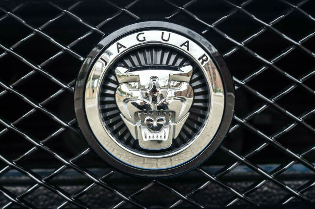

Wing emblem removed, new growler badge installed along with s badge.
Attached Thumbnails Mina Gallery front grill options-1510200783134.jpg   Mina Gallery front grill options-1510203116866.jpg

No it's not the mina grill it's the standard xk grill with the wing emblem removed and a black grower badge purchased from eBay.

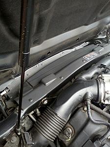

The other option for those who aren't entirely confident with removing one half of the bumper is to try and go through the top.
If trying to go through the top make surely you wear a long sleeve t shirt to minimize any cuts/grazes on the forearm.
In order to go through the top the radiator shroud will be needed to be removed, also the 10mm bolts and clips holding the front bumper
Attached Thumbnails Mina Gallery front grill options-1510966069758.jpg   Mina Gallery front grill options-1510966100614.jpg

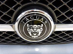

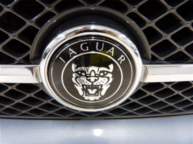

I think there is a noticeable difference between the flat older style and the not flat new style.
It isn't just the red that makes it pop.
Compare the old black version to the new black version.
Attached Thumbnails Mina Gallery front grill options-used-2007-jaguar-xk-2drcoupe-8730-13382298-67-640.jpg   Mina Gallery front grill options-jaguar-xkrs-review-growler-badge-carwitter.jpg
