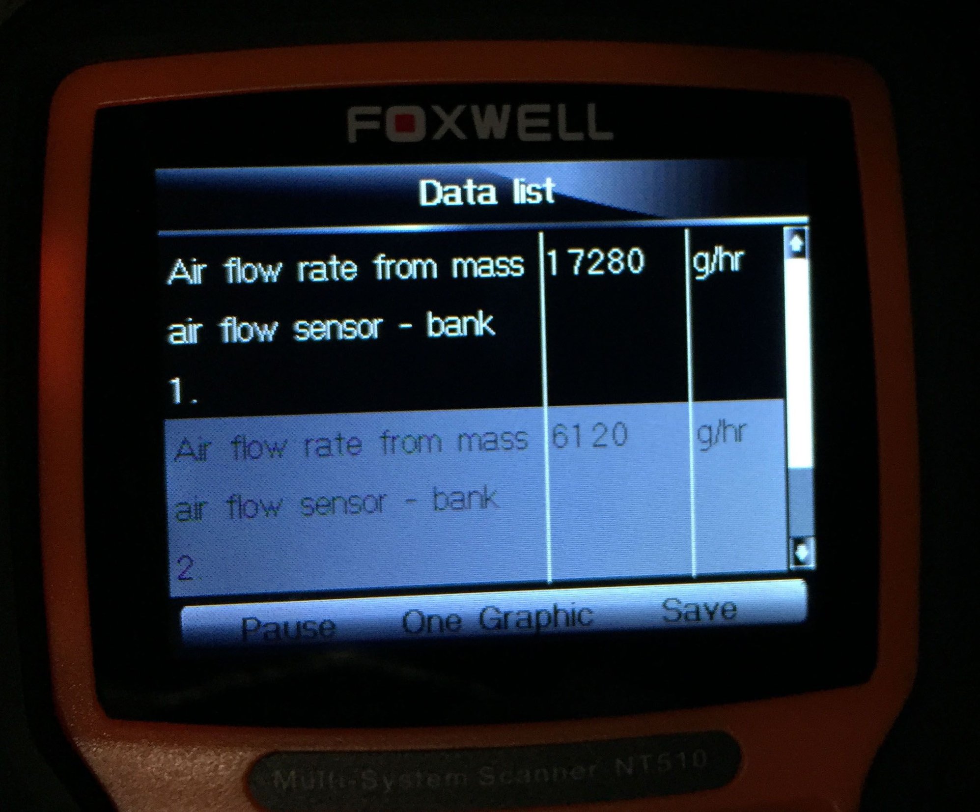

Default Air flow testing and no further progress
I ran some more tests on Saturday in between spreading mulch (on the flower beds, not on the Jag).
Air flow on the RH side was 25% less than the left. So I swapped over the MAF sensors left to right to see if the sensors were misreading. Observed no difference, i.e. the right side had a more restrictive air flow than the left. So then I removed the air filter on the RH side. AIr flow dramatically increased to 2.5 times that of the LH side. But, despite all that, the car still misfired on the right bank and the short term fuel trim was still -25% at idle. Conclusion: Even with plenty of air, the computer is still sensing it's way too rich on the right side and trying to cut it back.
I also noticed that the big negative short term fuel trim was happening even after we went in to closed loop. If I brought the revs up it would eventually straighten out and come down to -5% or so.
Next step is a bit unclear. I have to assume that several injectors are bad on the right side, perhaps not spraying properly and that it's just coincidence that 3 or so are bad on the same bank OR the upstream oxygen sensor is bad and stuck at .9v giving the computer a false rich reading. Seems unlikely. My scanner has voltage readings for Ox sensor 2 but I don't see the listing for the upstream sensor. There something called "Commanded Lambda ratio" or something like that.
The scanner pics for the air flow is with the RH air filter removed.
Old Mar 8, 2021 | 09:17 AM
  #31
mhminnich's Avatar
Joined: Oct 2014
Posts: 893
Likes: 704
From: Arlington, Texas
I would have suggested the rt MAF sensor until you swapped them. Now I agree with others that you might be looking at a stuck/leaking injector which is making the right bank run rich and the ecu accordingly trying to compensate but reducing fuel flow. A lean condition on cold start would definately lead to rough running.

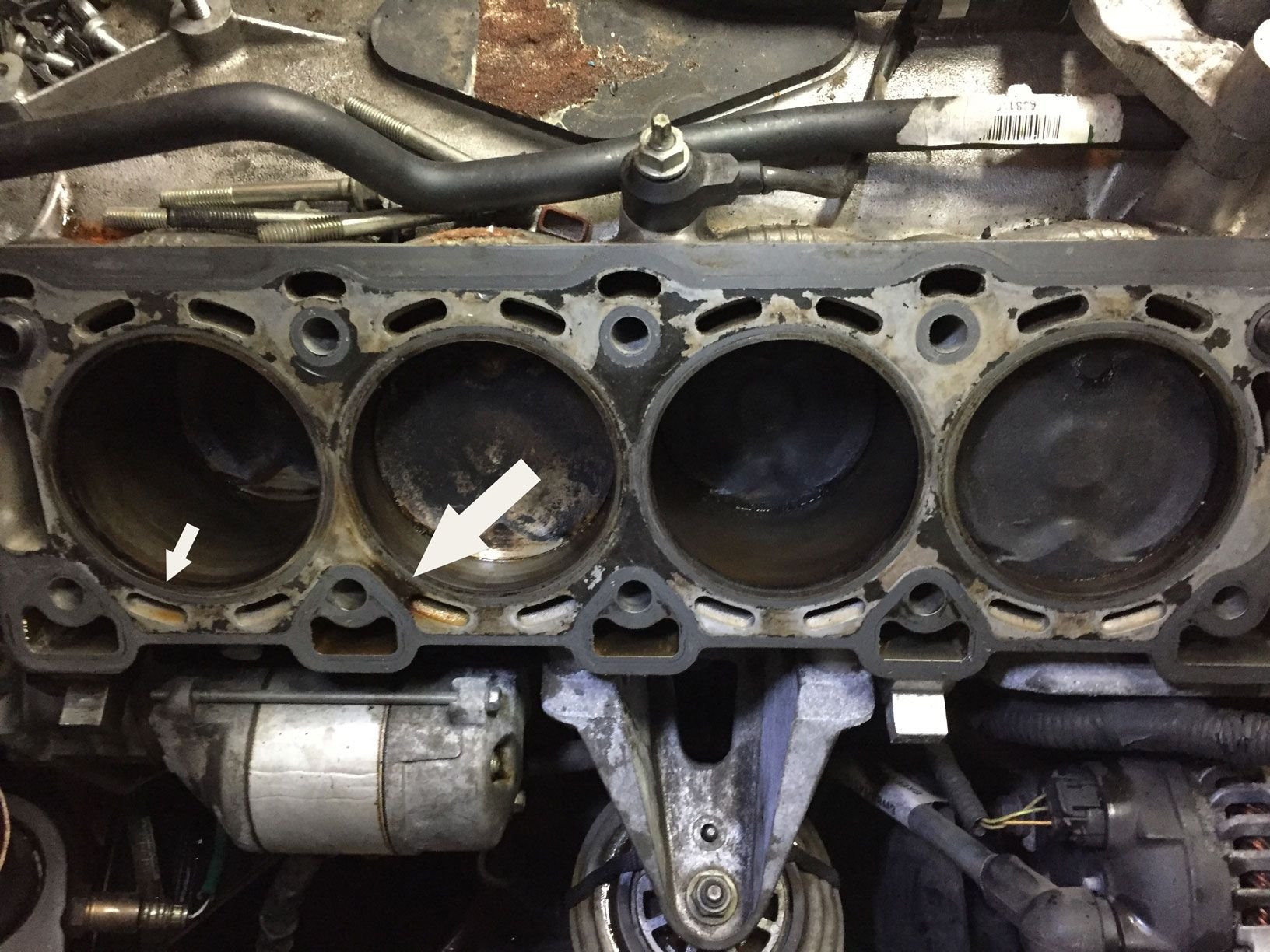

For anyone still following this saga -
I finally removed just the right hand cylinder head this evening.
Before I unbolted it, with both camshafts out, I re-ran the leak down test. i.e All valves should have been closed.
From left to right (front) cylinders 7, 5, 3, 1
With cylinders 7 and 5 the compressed air bubbles into the coolant channels (I could hear it)
Cylinder 3 was also leaking, about 50% loss, I think through the valves not closing fully.
Cylinder 1 passed the test (less than 10% leakage) and was good.

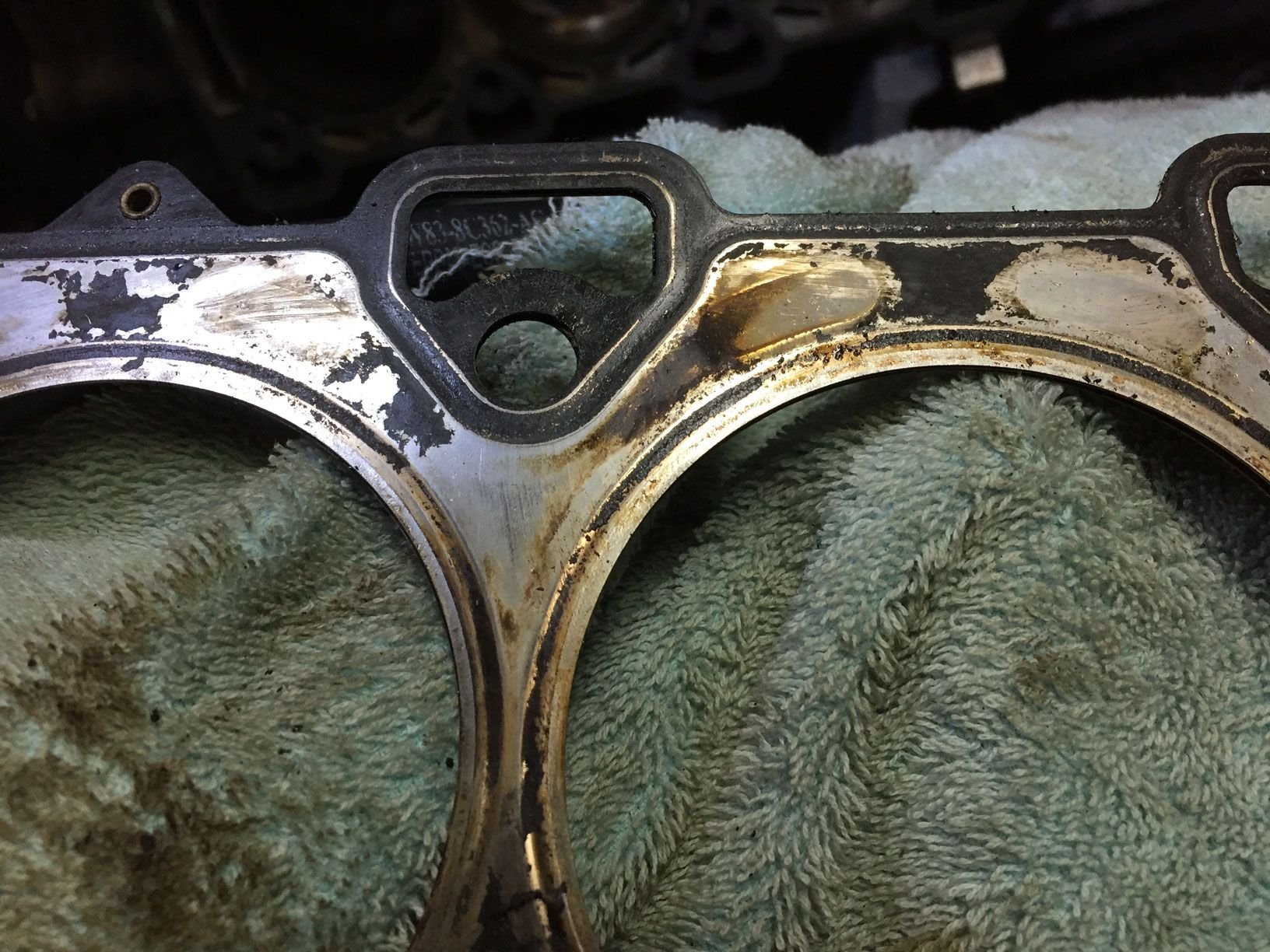

There’s no visible breaks in the head gasket.
In the photos I have simply wiped the gunk off the surfaces but not cleaned them up yet.
There’s brown burn marks from cylinder 5 into the coolant channel and possibly from 7 into 5 or maybe to a coolant channel too.
I did a quick straight edge check on the head surface and it didn’t seem warped but maybe I need to get a lot more sophisticated and careful about that test.
So it looks like there has been leakage between the gasket and the nearest block coolant channels on cylinders 5 and 7.
Why that has happened, I don't know. the car was misfiring from cold before it went all the way from Virginia to Florida and back.
Maybe I'll clean up the head and see a crack right there but for now it's not obvious.
Those head bolt are very tight. It was quite a work out to undo them. I was scared I might strip the head of the bolt but they let loose with an initial crack and then a subsequent double crack on almost everyone.
Here’s photos of the RH, gasket, head and block.
