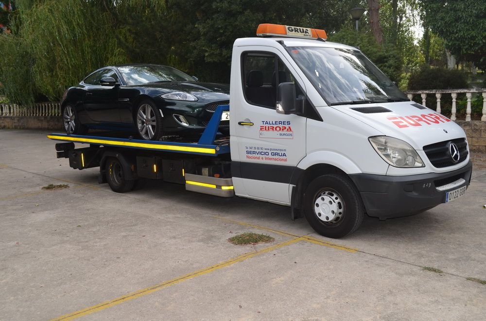

......... and it's very exciting when you're 2 countries and 1200 miles away from home with another 800 miles to go.
Four days in the local Jaguar Dealer to get a new injector, change the plugs and engine oil. That puts a dent in the holiday budget.

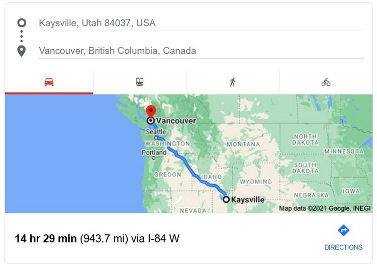

I think it would easily get you out of the United States ........?
