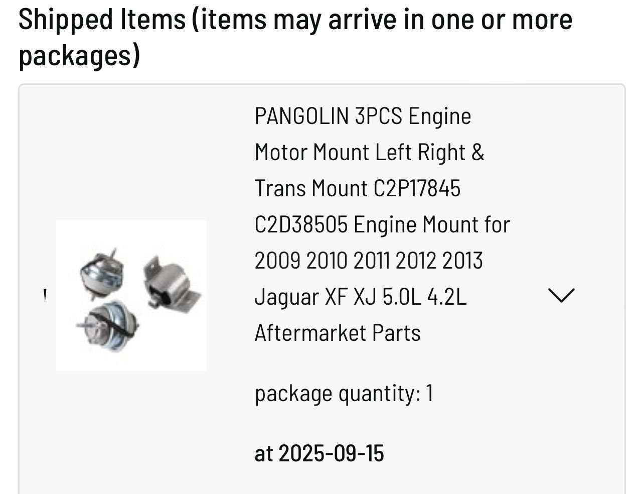

@Street cat
If you decide you need new ones, I got both for $180 including the trans mount. Aftermarket of course.
Site called IB Spot.
The ouch is install. Both my Indies want $800.
A third I called wants $960.
After digging through the forums, these XF are an exact match. Haha I hope.
