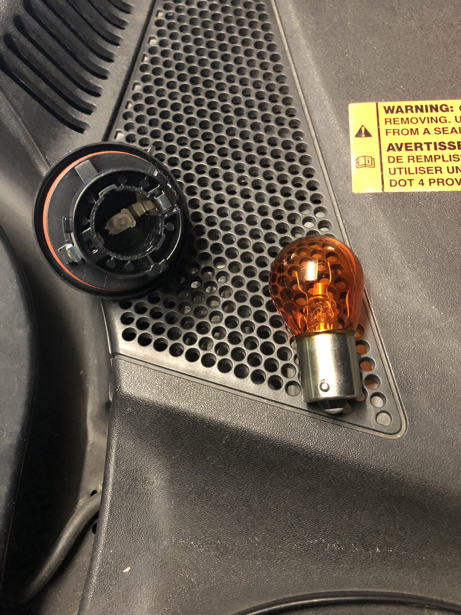

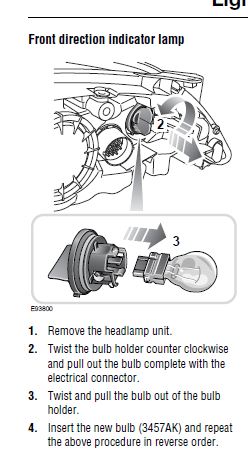

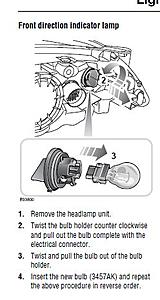

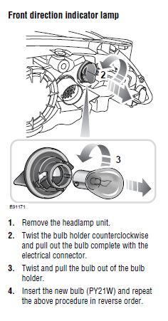

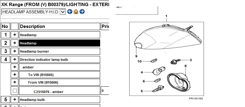

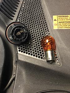

I am officially confused! I double checked which turn indicator bulb I had in the head lamps on my '10 XKR today and, as you can see, the link I listed is correct for my car.
I see that the Owners manuals have different pictures in depending on market but that isn't reflected in the parts system. The only bulb they list is the one I have.
Unfortunately in the process of putting the headlamp back in I managed to drop one of the bolts and it disappeared down on to the under tray! As I bought some new air filters a few months ago I thought I might as well take the wheel off and drop the wheel arch liner to try and find the bolt and change the filter while I was there. Luckily I could see it so was able to fish the bolt out with a magnet.
