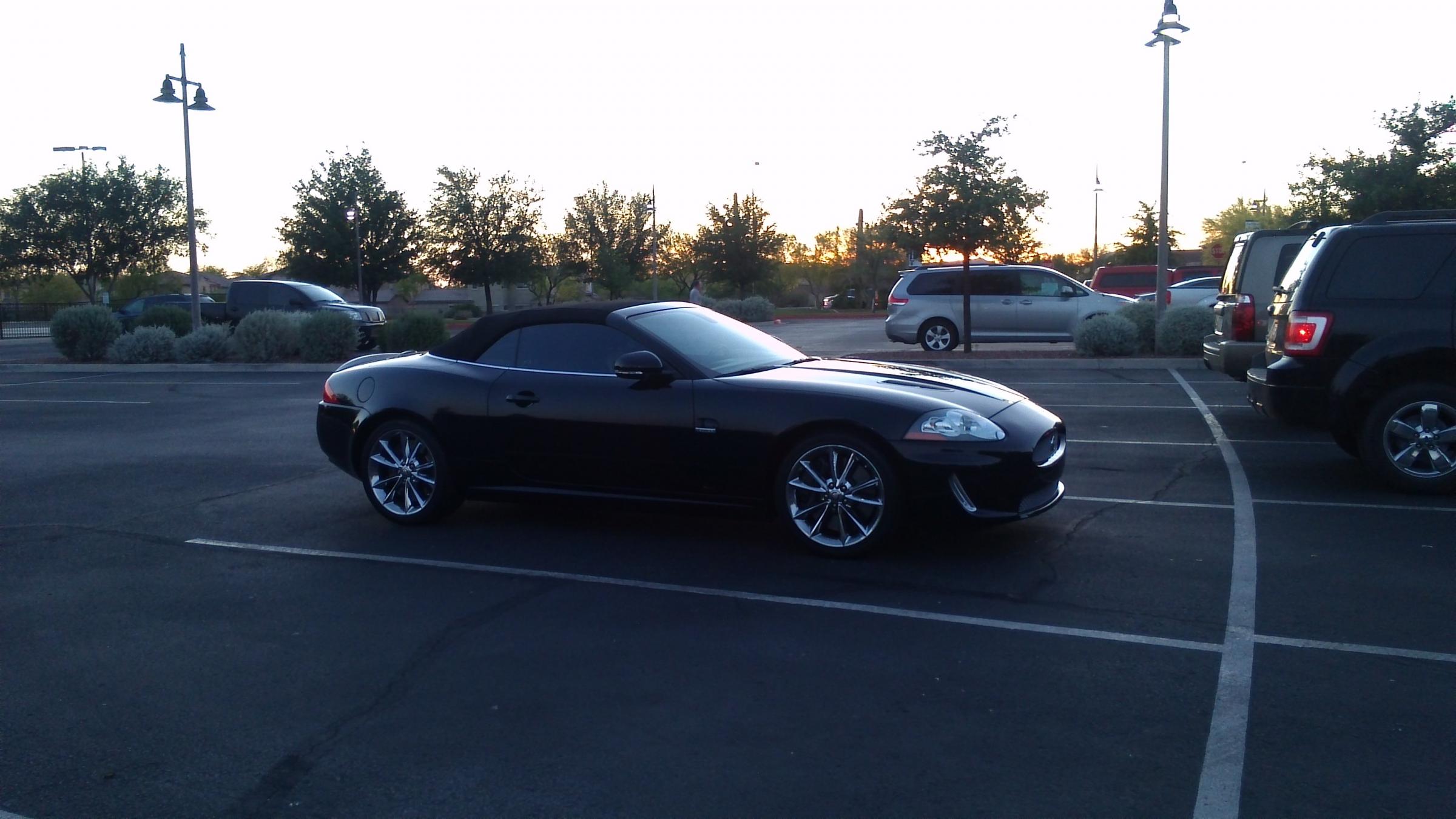

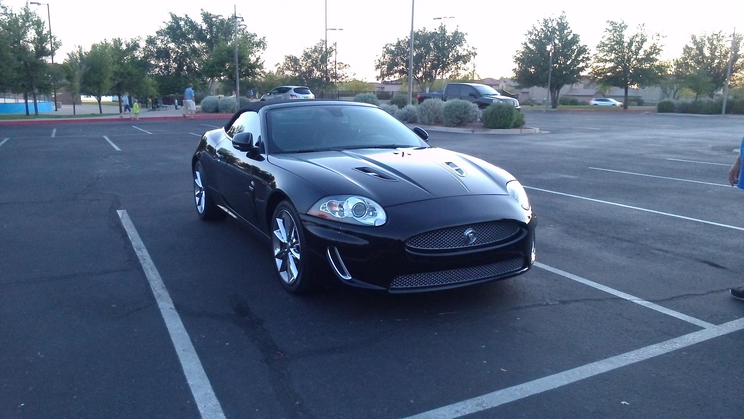

Sorry, I needed to upload some "before pics" I guess. Well, there they go....Just an average, if there is such a thing, black w/charcoal interior XKR.
Attached Thumbnails My XKR is 5 months old (to me) Time to mod, I have questions, would love opinions-win_20140421_190855.jpg   My XKR is 5 months old (to me) Time to mod, I have questions, would love opinions-win_20140421_190942.jpg
