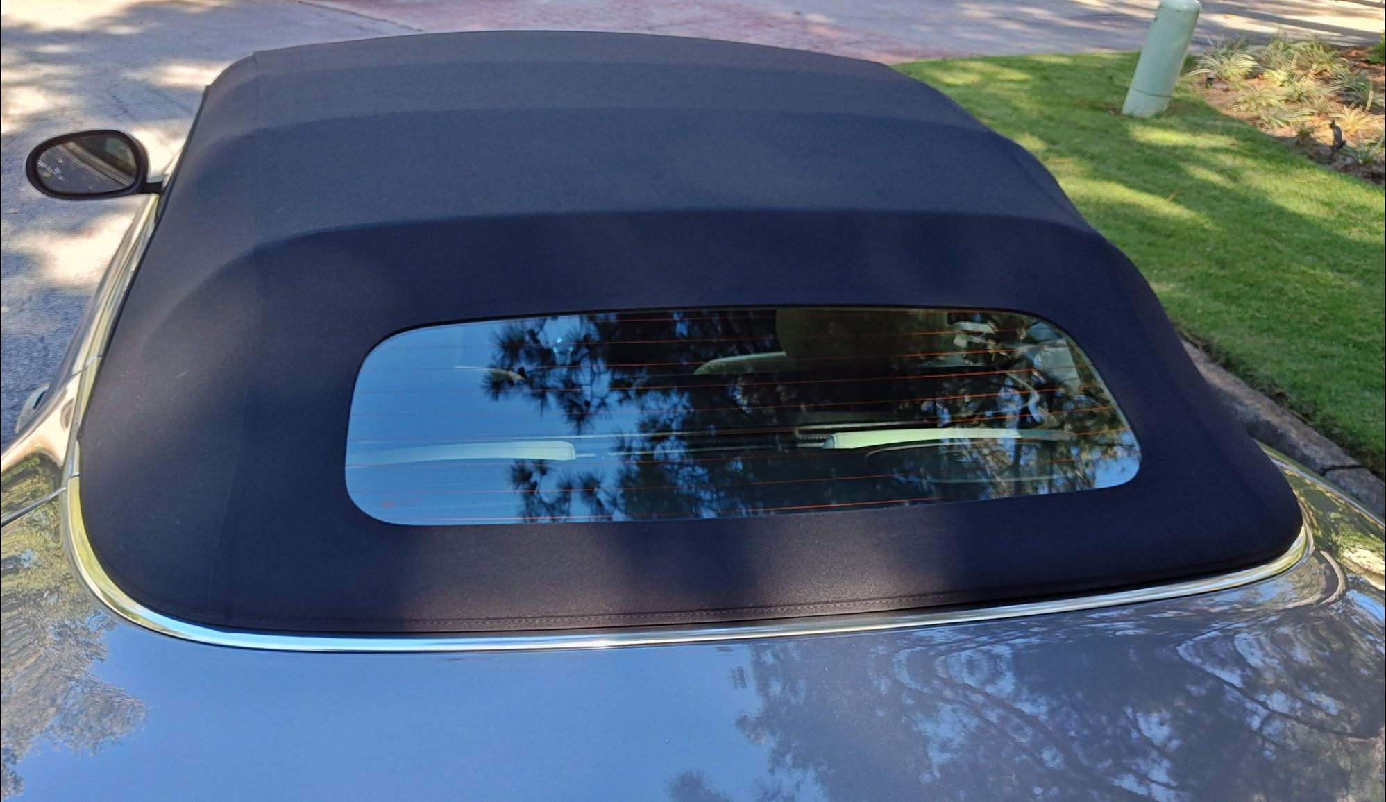

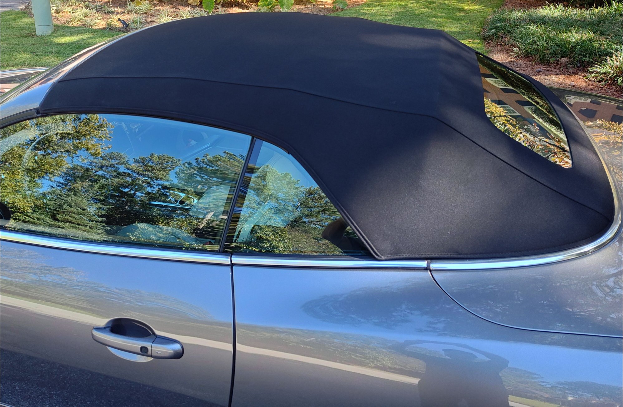

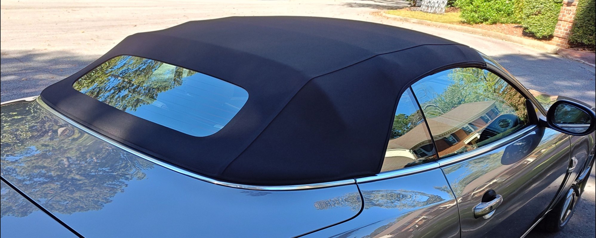

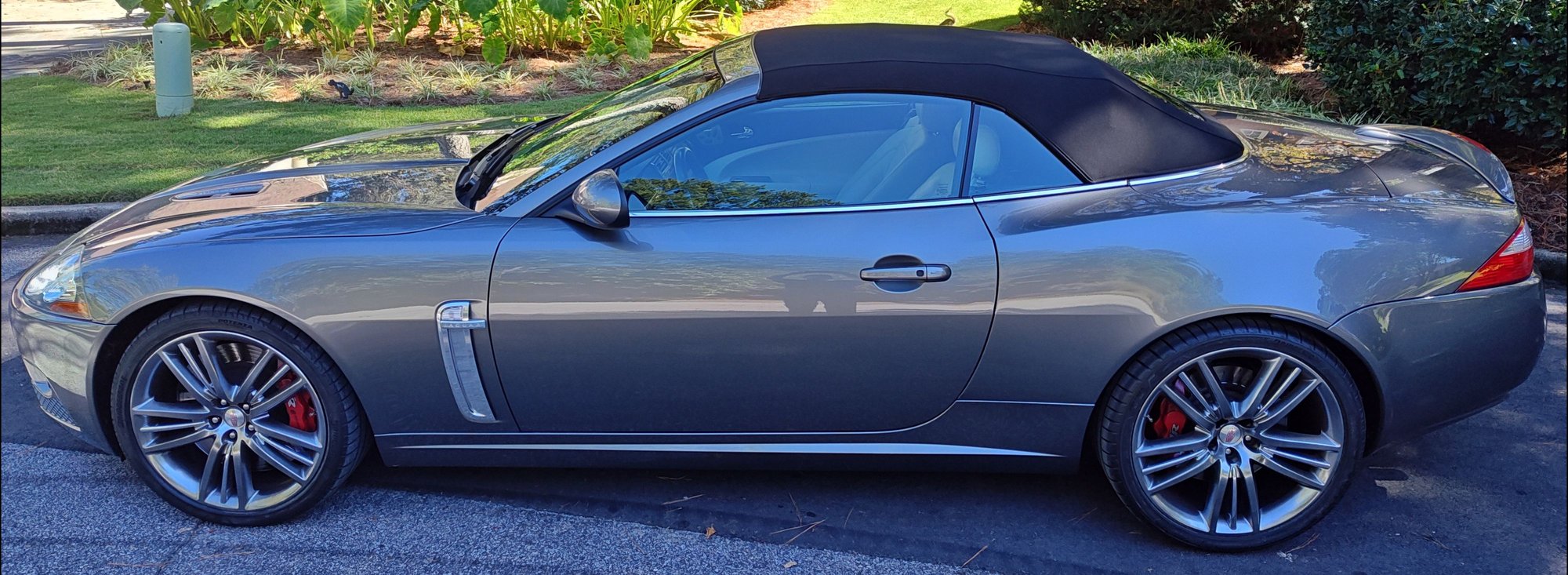

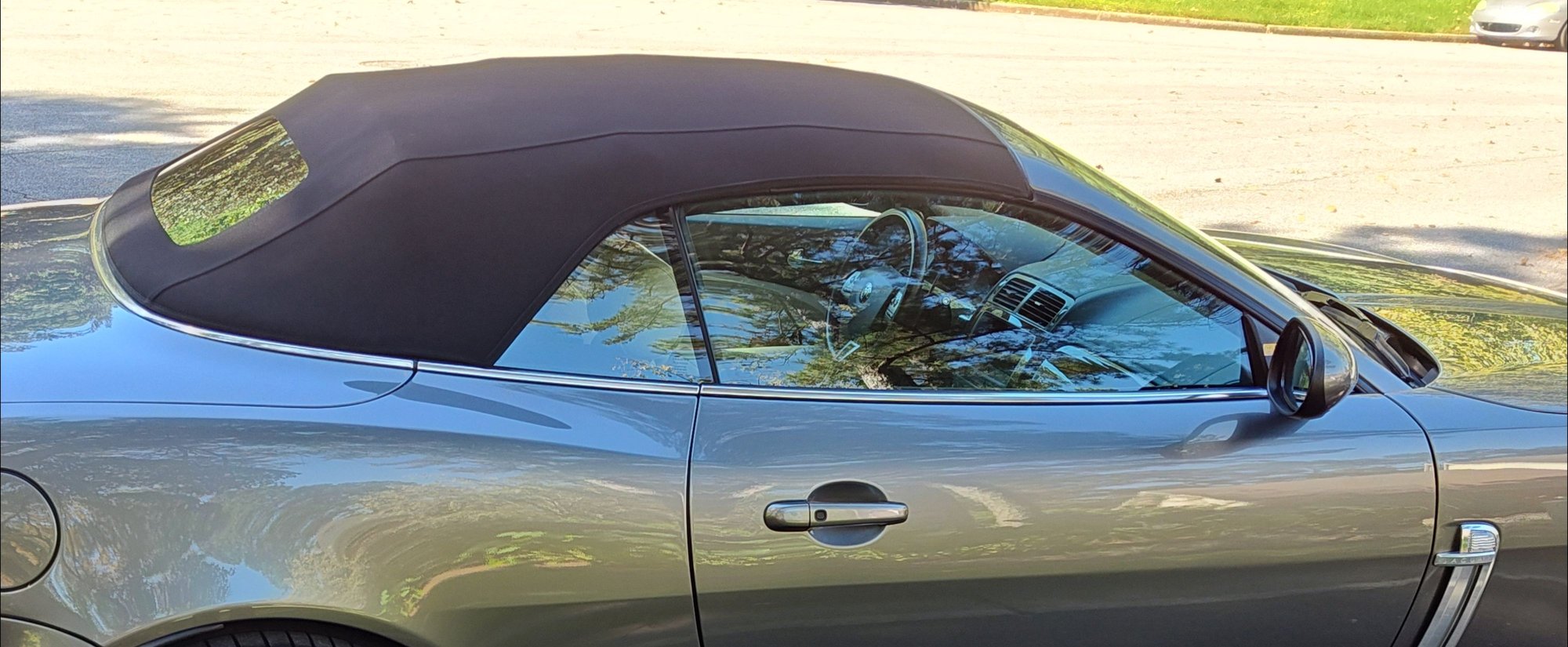

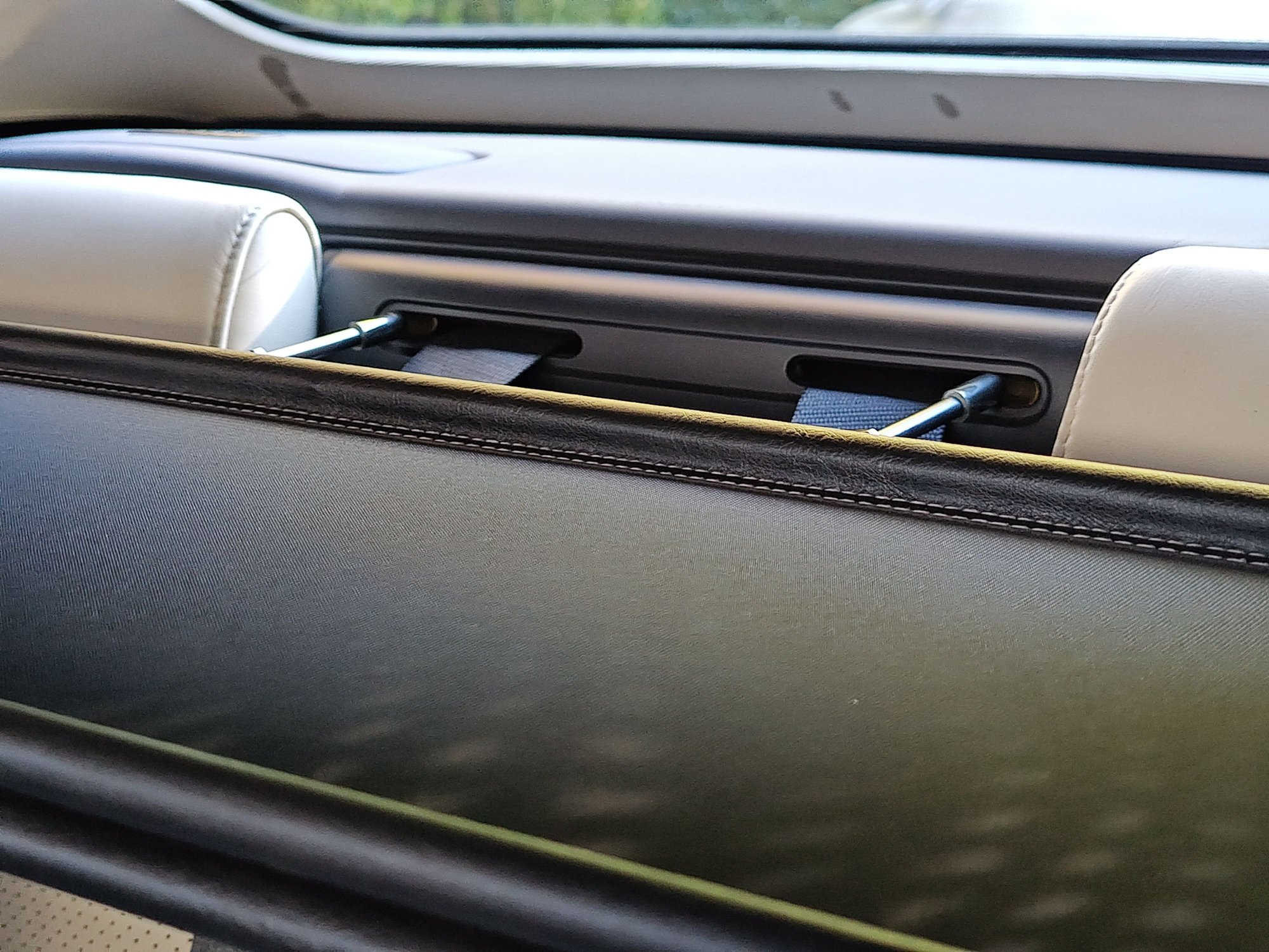

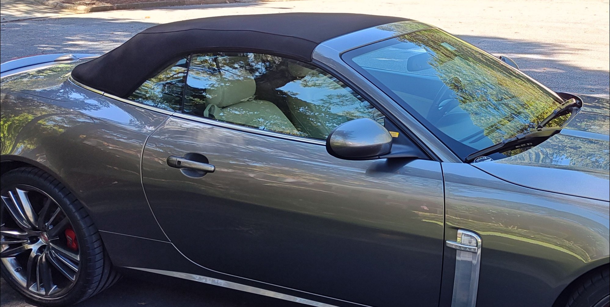

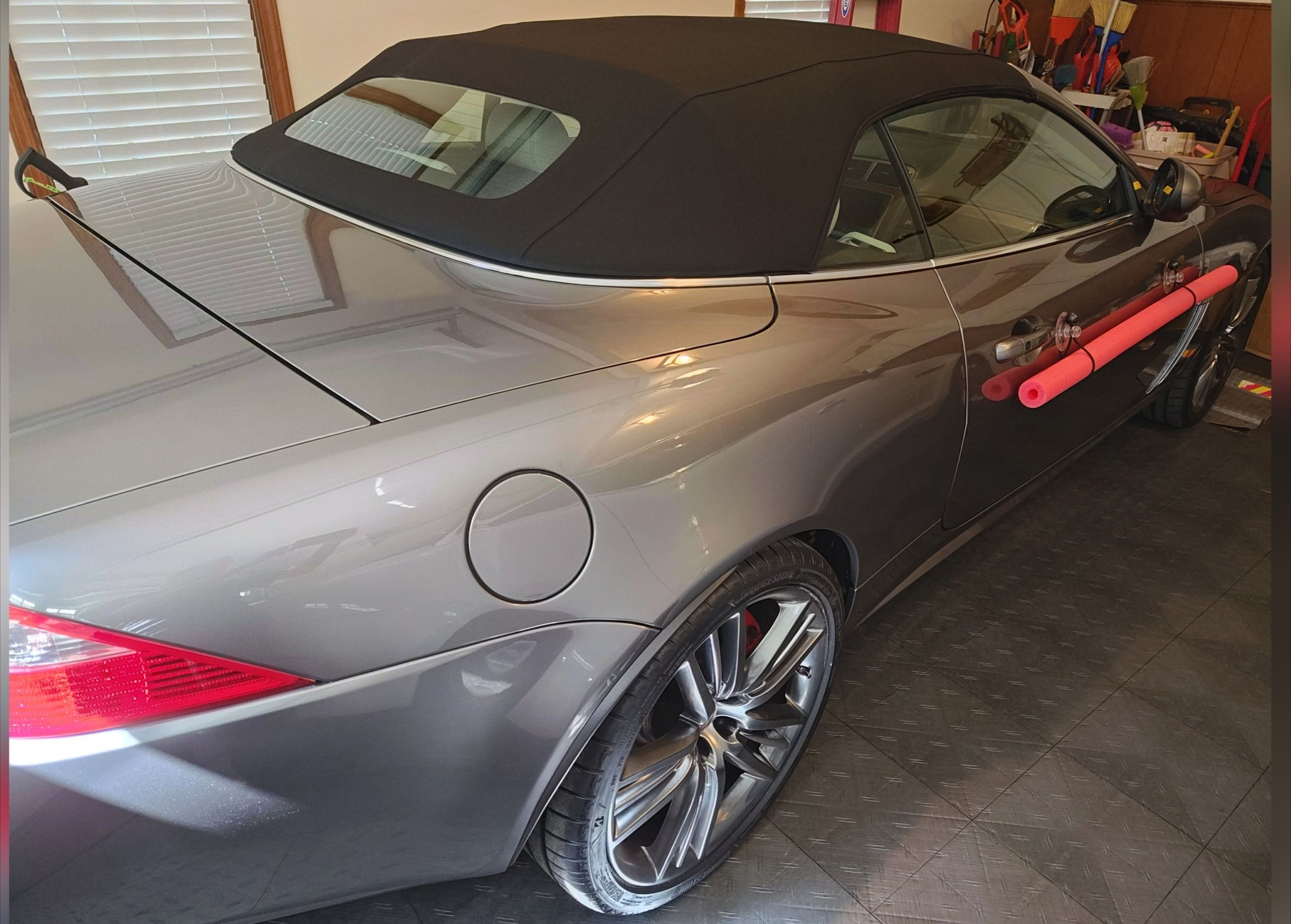

On October 9, I had a new top installed on my 2009 XKR Portfolio Edition Convertible. After much research, I bought the top from OEM+ Auto Tops. Here's their website:
OEM+ Auto Tops
I had my new top installed by Kenny McCombs, The Convertible Top Man, because had great reviews and is mobile. He installed the top in my garage and explained everything he was doing while I watched. If you think you can DIY, think again. Although it's easy to remove the old top, installing the new one requires the right tools and adhesives and knowing the proper sequence of reassembly steps. Kenny didn't use an instruction manual. I highly recommend him. Here's Kenny's website:
Atlanta Convertible Top Mobile Installation
(Not my XK)
Kenny told me that I made the right decision to buy the OEM+ top because it has the best fit. We had to press down on the front header to get the latches to close into the windshield. He said that was normal and to leave the top up so the fabric can stretch out. After he left, I misted the top with water, which dried overnight in my garage.
Below are photos of the completed job.
If you decide to consider using Kenny to install your top, tell him that I sent you.
