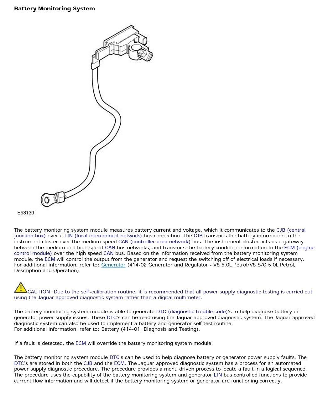

From the X150 5.0L Workshop Manual:

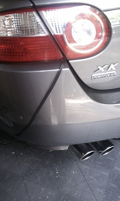

Originally Posted by Alster370

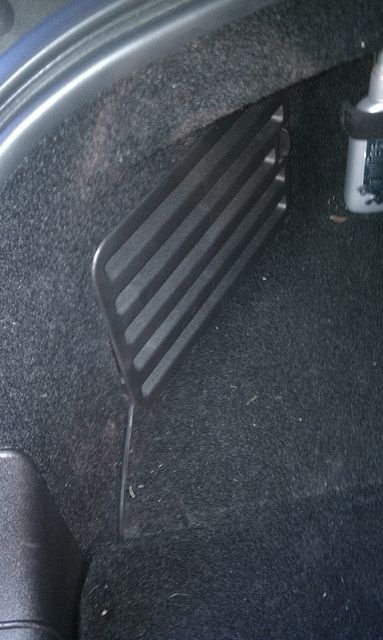

Don't worry I did the remote hook up, using a nearby ground behind that little cover as suggested by another member.
The remote positive battery terminal is behind that cover. The remote negative (ground) terminal is in front of the spare tire.
My XKR hookup:

Bill, the 5.0L X150 Workshop Manual says that the ECM will override the BMS Module if a fault is detected. The Owner's Handbook for my 5.0L 2013 XJ emphatically states "Do not connect a booster cable to the negative (-) terminal of the battery." I interpret those statements to mean that connecting the negative pigtail directly to the negative battery terminal BMs Module can cause the BMS Module to be bypassed and replaced by the ECM.
It seems to me that we're arguing about semantics - the branch of linguistics and logic concerned with meaning. It doesn't matter to me what you call it because I hope we're all in agreement that if it walks like duck and talks like a duck then it's a duck.
Bottom line: Attach the negative pigtail to a chassis ground, not the negative battery terminal. Time to stop

No where has Jaguar ever stated the BMS will be damaged all they are saying is direct connection via a booster* is not the appropriate manner of connection. BMS is used by other manufacturers as well and it is known when using a maintainer the connections must not be direct to the battery so the BMS is able to properly account for the trickle charge.
*Speaking of semantics a booster is NOT a maintainer! A booster is used for jump
starting and I reckon jump starting via the BMS COULD damage it.
I’ll also take this opportunity to add that my experience with BMS has shown it to be an utter failure at improving battery life. I’m on AGM battery number 4 and BMS module #2 in a 5 year period whereas the 12 year old rarely driven XKR is on battery # 2 now.

The technical guide for the 5 litre does mention maintainers as well:
