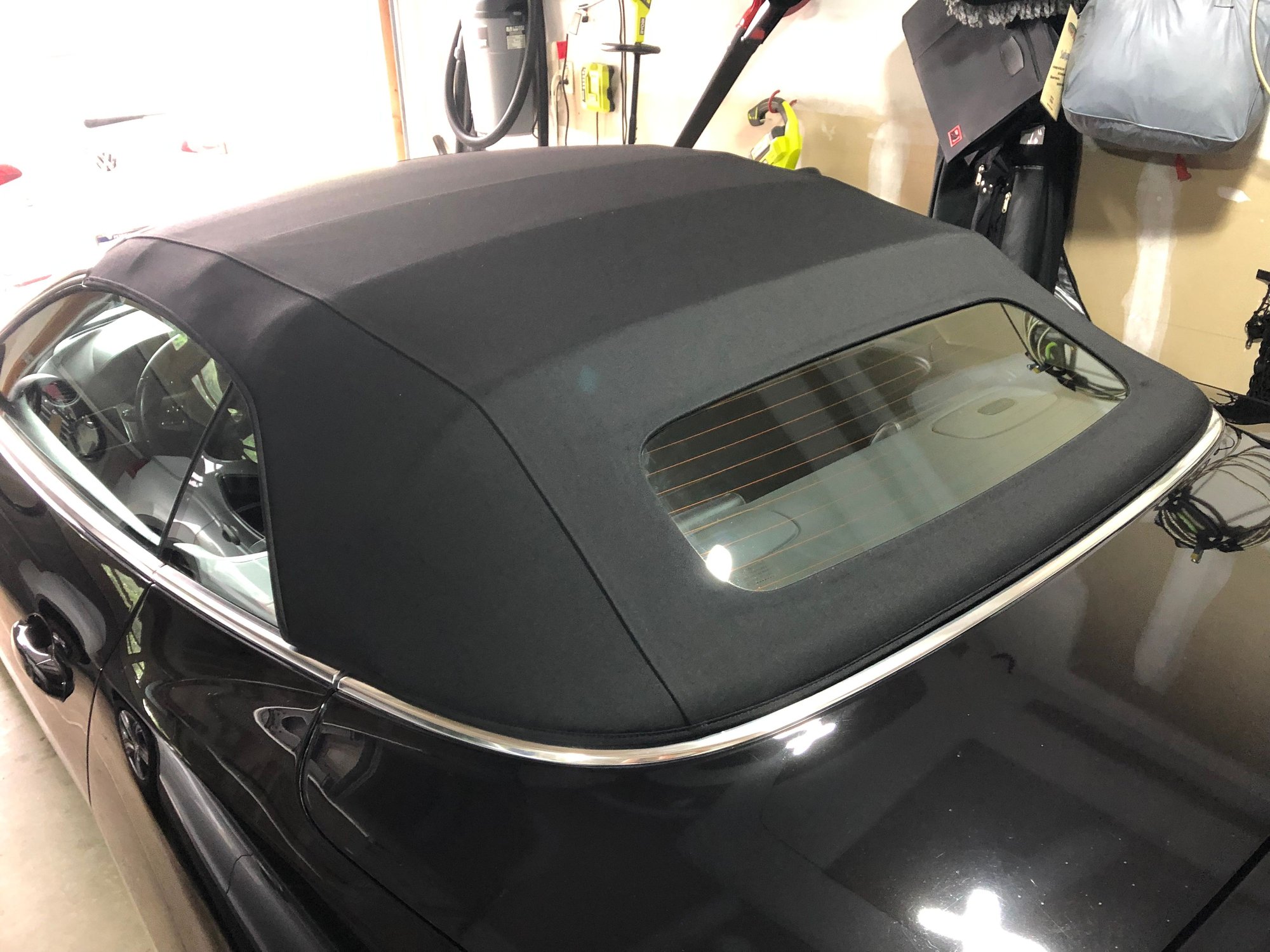

I just replaced my top with the GAHH version. It looks like OEM, includes the rear window but doesn’t include the interior liner. Highly recommended.

Accurate Auto Tops, Edgemont, PA did the install. $2800.00.
