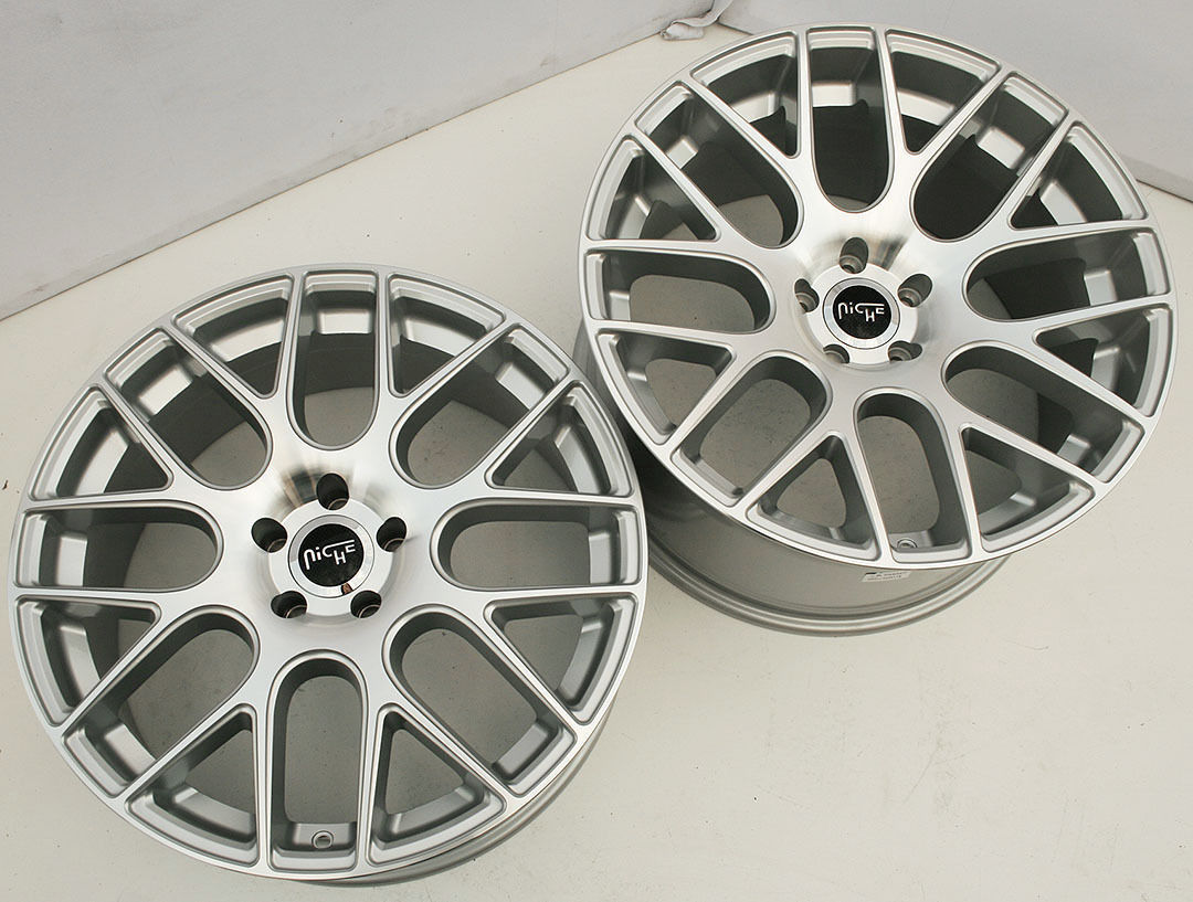

Here are some pictures of the wheels that I chose that would require spacers and hub rings. They are being discontinued so the price is right.
Wheels with shipping plus the spacers and the rings shipped will be right at $1050.
Custom machined to fit wheels would eliminate an extra tolerance stack up from the second hub fit, I understand.
Assuming they have a nice close slip fit I do not see an issue with rotation adding one more concentric hub fitting.
Attached Thumbnails New wheels on a 2010 XK-circuit_3pc_porsche_panamera.jpg   New wheels on a 2010 XK-ferrari-2_o.jpg   New wheels on a 2010 XK-niche-circuit-sl55-wheels-silver-1.jpg

Appreciating the input. I have purchased the Niche wheels and should have them next week. I will verify the wheel hub bore and order the custom made hub rings and spacers. That should take a few weeks. I will post on the install.

Correct. I am rather partial to these discontinued wheels.
Actually, I only need spacers on the rear because I want the wheels to sit out 15 mm from stock. The hub bore on the wheels does not match the car so I will need to adapt for that also on all 4 wheels.
I am doing this to save money (and get the wheels I like). I am getting the wheels for $717 + 99 shipping. The spacers and the rings will be custom made to order for $140 + shipping. The tire swap should be around $70 which totals to $1046 complete.
I do not see an issue with mounting wheels with properly manufactured spacers and hub rings and I do not agree with any issues relating to bearing wear on the 15 mm space out of the wheels.
