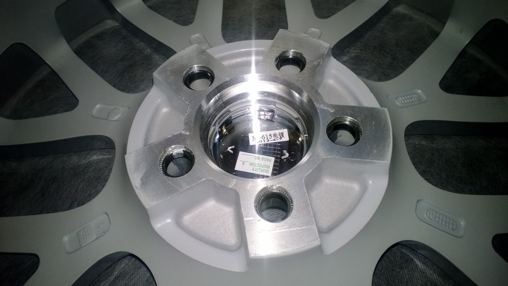

I trial fitted the wheels and I have a few issues.

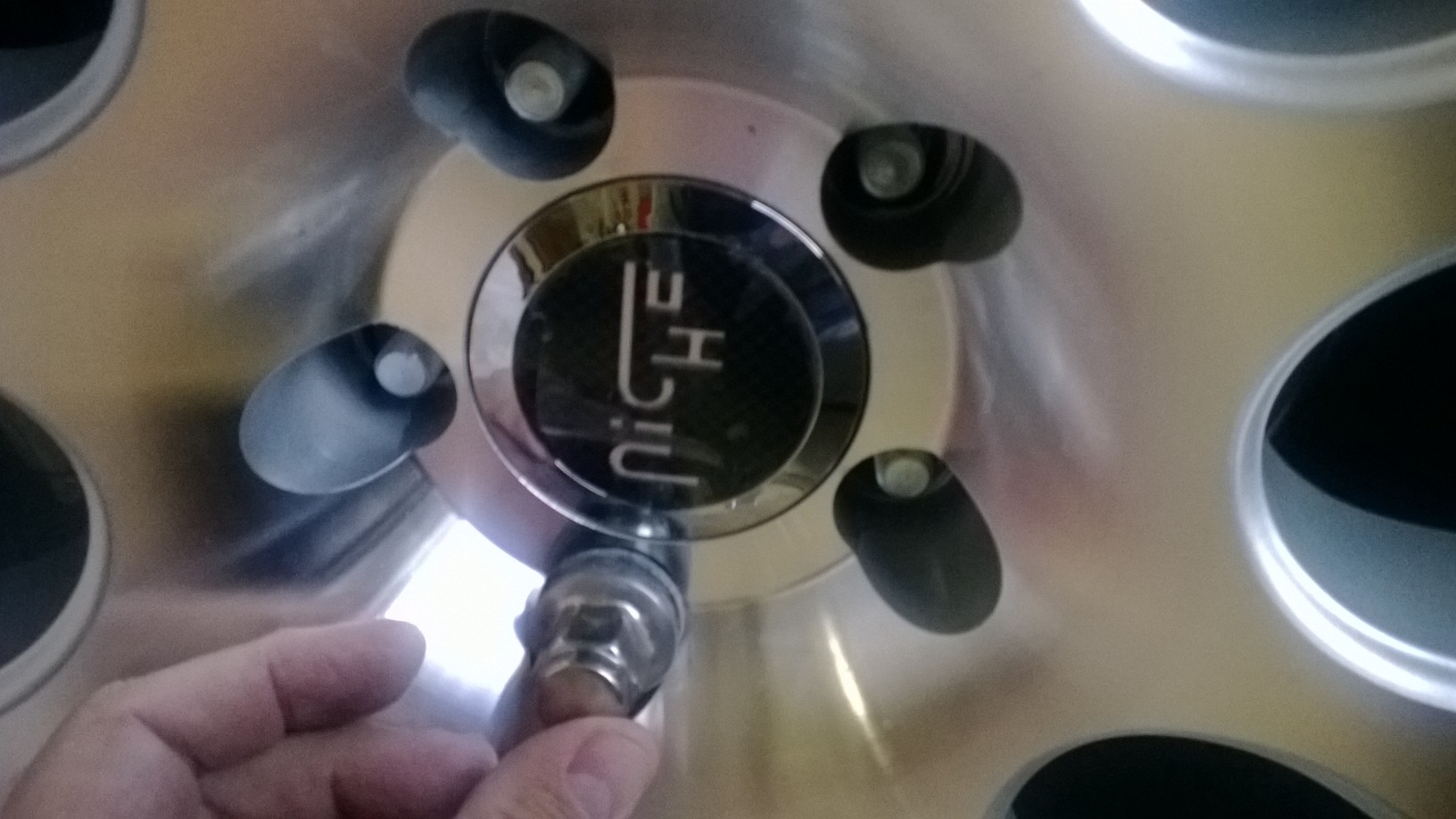

1. Original nuts do not fit in the counter bored hole of the new wheels. See attached pic. I'll have to find some new nuts.

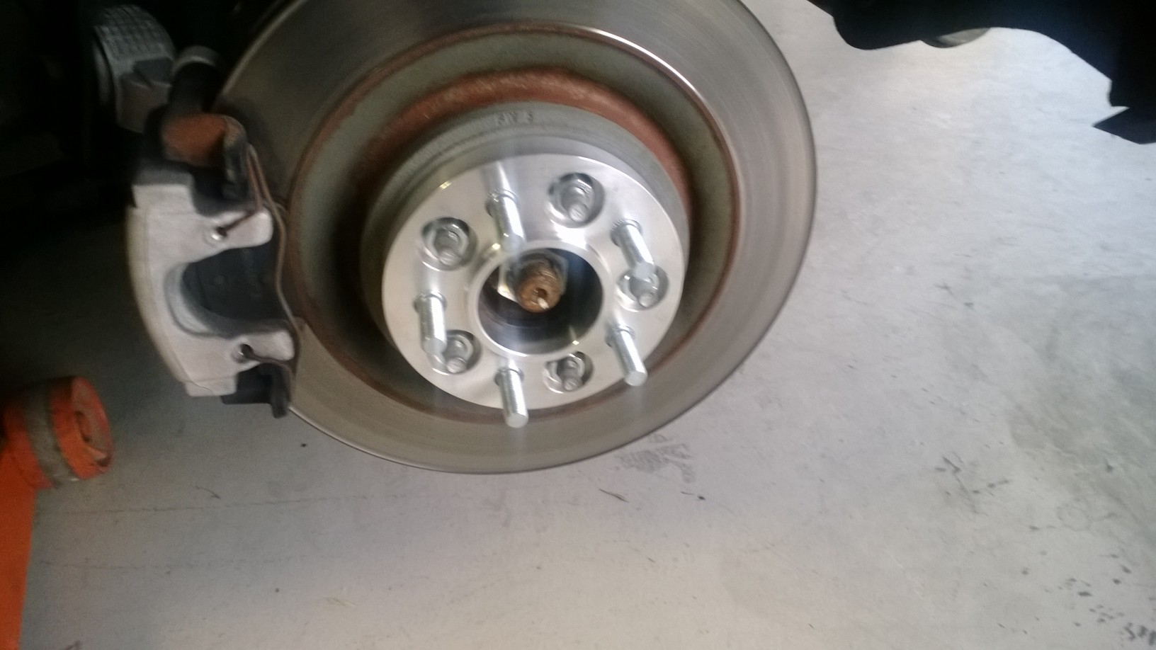

2. I ordered the spacers 20mm thick and this is too much for the look I want. I won't go thru the details of the stack up but basically with a 15 mm spacers up front and none in the rear, the wheels will be sitting 15 mm further out up front and 10 mm in the rear.
3. The spacers and rings fit perfectly with a nice snug slip fit. No feel able play.
4. I have plenty of space in the wheels for the cars studs to stick out beyond the spacer and not interfere with the wheel.

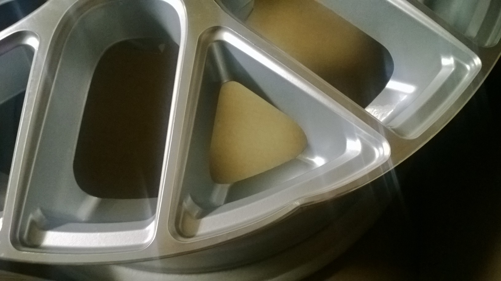

5. One wheel has rim damage. I didn't know what to expect from the vendor I purchased from on eBay, but the experience, so far, has been stellar. They will replace the wheel and I can keep the damaged one. 2-3 weeks to get the new wheel so I am taking the damaged one to a local wheel repair shop this morning and see what can be done for what price. I have attached a pic.

That's a nasty little "ding" ya got there mate. Me thinks, a good wheel shop can fix that, though.
I spent $600 to get my Cremonas ship-shape, as one was cracked. So, for $600 *******, I now have another set of wheels and tires for me Jag.
When I replaced my wheels, I too, I needed to order correct lugs. I still have my OEM lugs to go with the Cremonas.

You will most likely need to secure a set of "tuner" spline type lug nuts for the new wheels.
I had to buy the same type for the aftermarket wheels on my 2009 Jag XKR PE.
They are available from Amazon. Be sure to buy a good quality set, as quality does vary.

I went down to Wheel Specialists in Tempe Saturday morning and was quoted $200 for wheel repair and no guaranty the would not crack during repair rendering them useless, so that was an easy call. I will check some other places.
I have measured the front wheel face location again and came up with new numbers. Measure twice right? bottom line is that I now need an 8 mm spacer. I will modify the 20 mm pacers that I had made.
The damaged wheel is usable according to Wheel Specialists.
I bought a new se of splined lugs. Thanks Richzak. Thanks GrtShrk for the thumbs up.

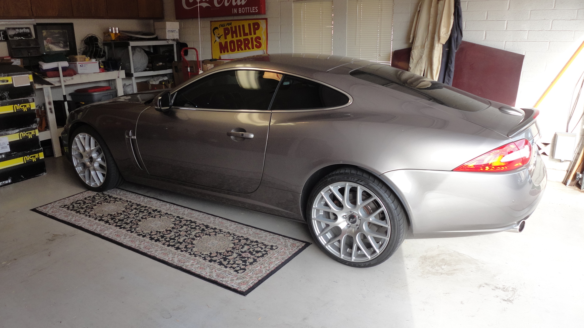

Well...I finally got the wheels on. Very happy with them. The outside face of the wheels sit 15 mm beyond stock and I love the look. Here are some pics. By the way the car drives and handles like original.
I'll try and get the car out and get some better pictures soon. I just had hip replacement surgery 17 days ago and still under some restriction.
