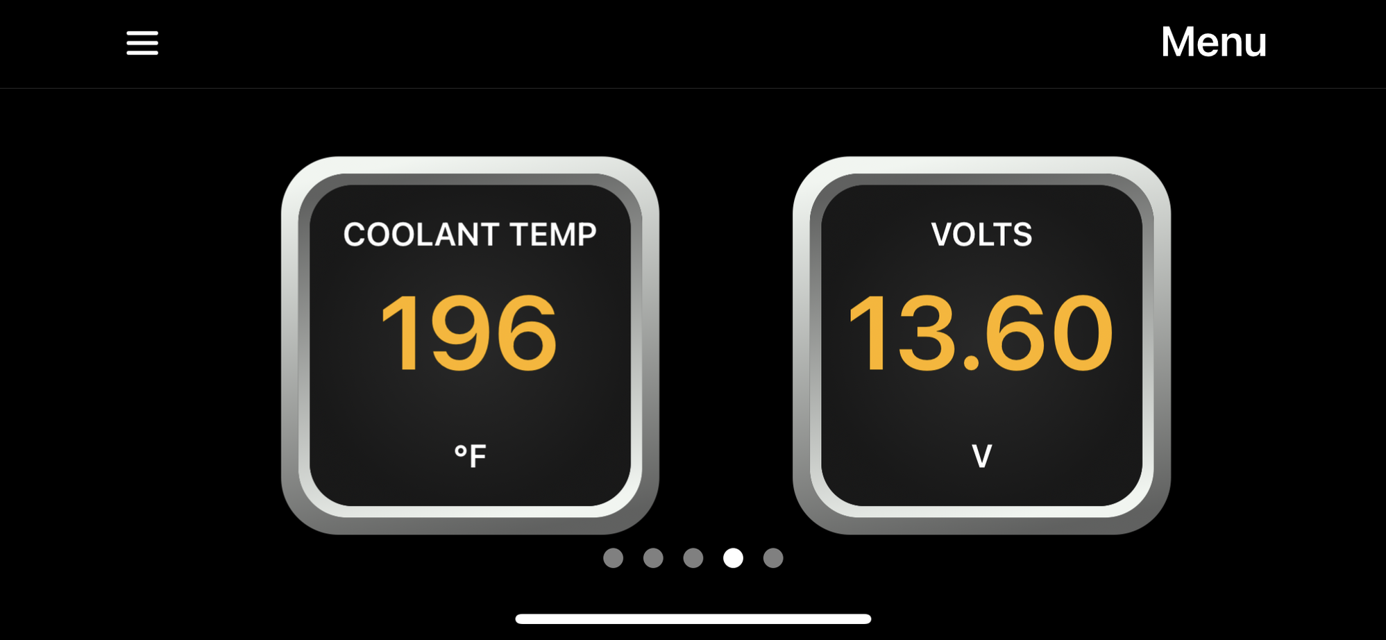

I purchased a Veepeak OBDCheck BLE+ Bluetooth 4.0 OBD II Scanner Wireless Car Diagnostic Scan Tool on Amazon and downloaded OBDFusion from the App Store. Then I created this Temperature and Voltage gauge dashboard which runs on my iPhone. It rests nicely in front of the ashtray door and is easily readable.

Terrific, but why is it posted in a music streaming thread?

Sorry, posted into wrong thread and don’t know how to delete a posting.
