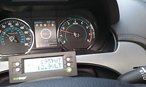

Originally Posted by Rey
I think a good all-around "gauge" is the ScanGauge. It is quite small and easily fits on top of the steering wheel pad. It connects to the OBDII port. It monitors a lot of functions including voltage, coolant temp, fuel pressure, miles per gallon, speed, and, of course many default codes (sic). It can also clear codes temporarily or permanently, depending upon the severity of the fault. It does not read oil pressure - wish it did.
Its readings reflect exactly what the motor and drive train sees; and these readings may or may not be totally accurate. But for our purposes, they work well enough.
The point I was trying to make above is that a battery may well have enough to start a car, but that does not necessarily mean it is "healthy." The three year old battery I took off had no problems whatsoever starting the car. Yet, it was not fully charged through daily driving. I put it on my bench with a Battery Tender and it took 10 hours for it to reach full charge (as per the Battery Tender).
It's a cheap investment but tells you what you want to know. Just to bad we need to buy it.
