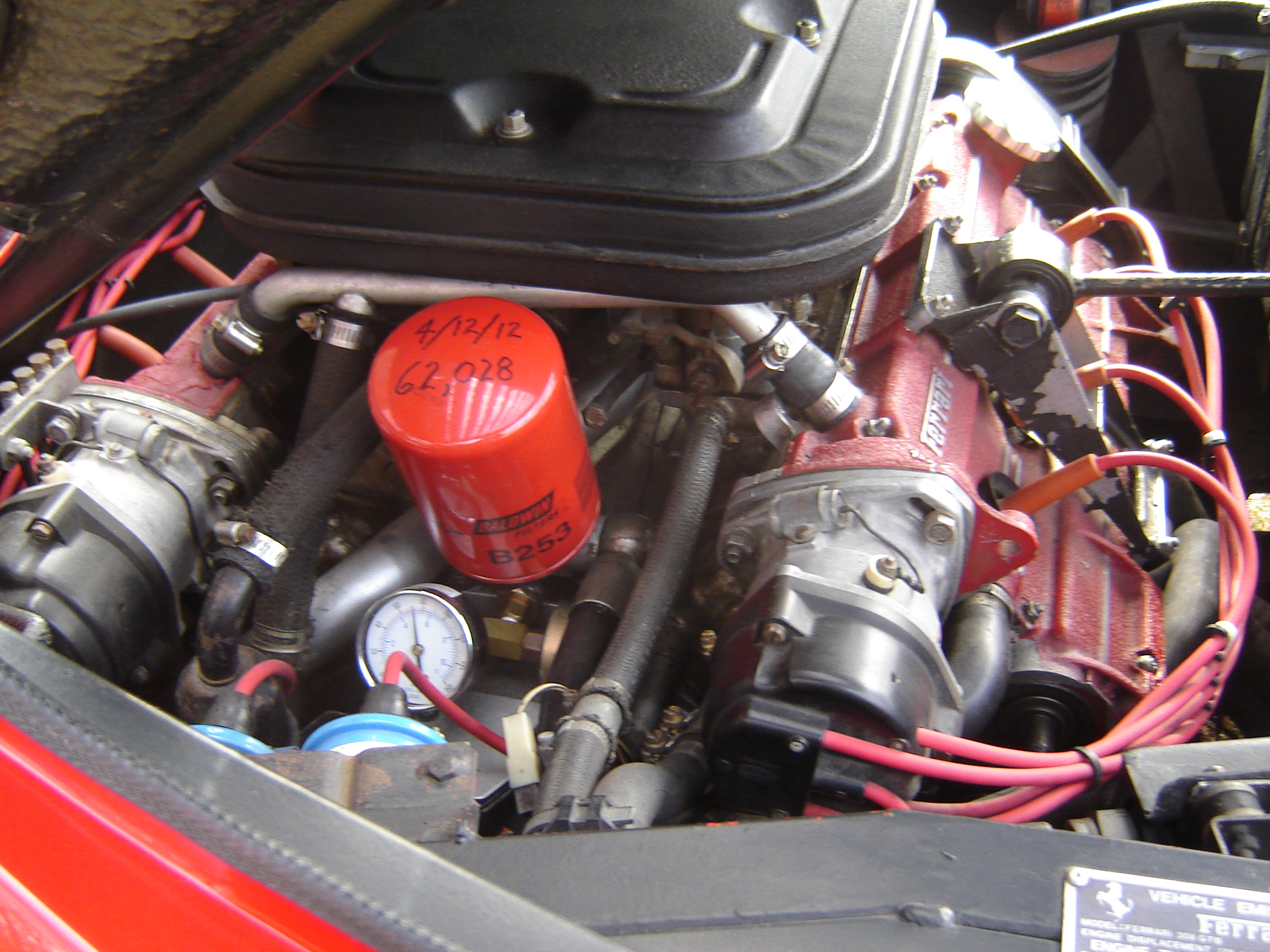

I do not believe you can buy an oil pressure sensor that would work through the OBDII system connector. I have to believe there is a way that the factory can tap into a fitting (like the low oil pressure warning switch) and install a OP sender which you can attach to a gauge either in the engine compartment or located in the cockpit. When I had an OP issue on my Fcar I installed a parallel gauge to verify the electronic gauge was reading correctly (see pic).
