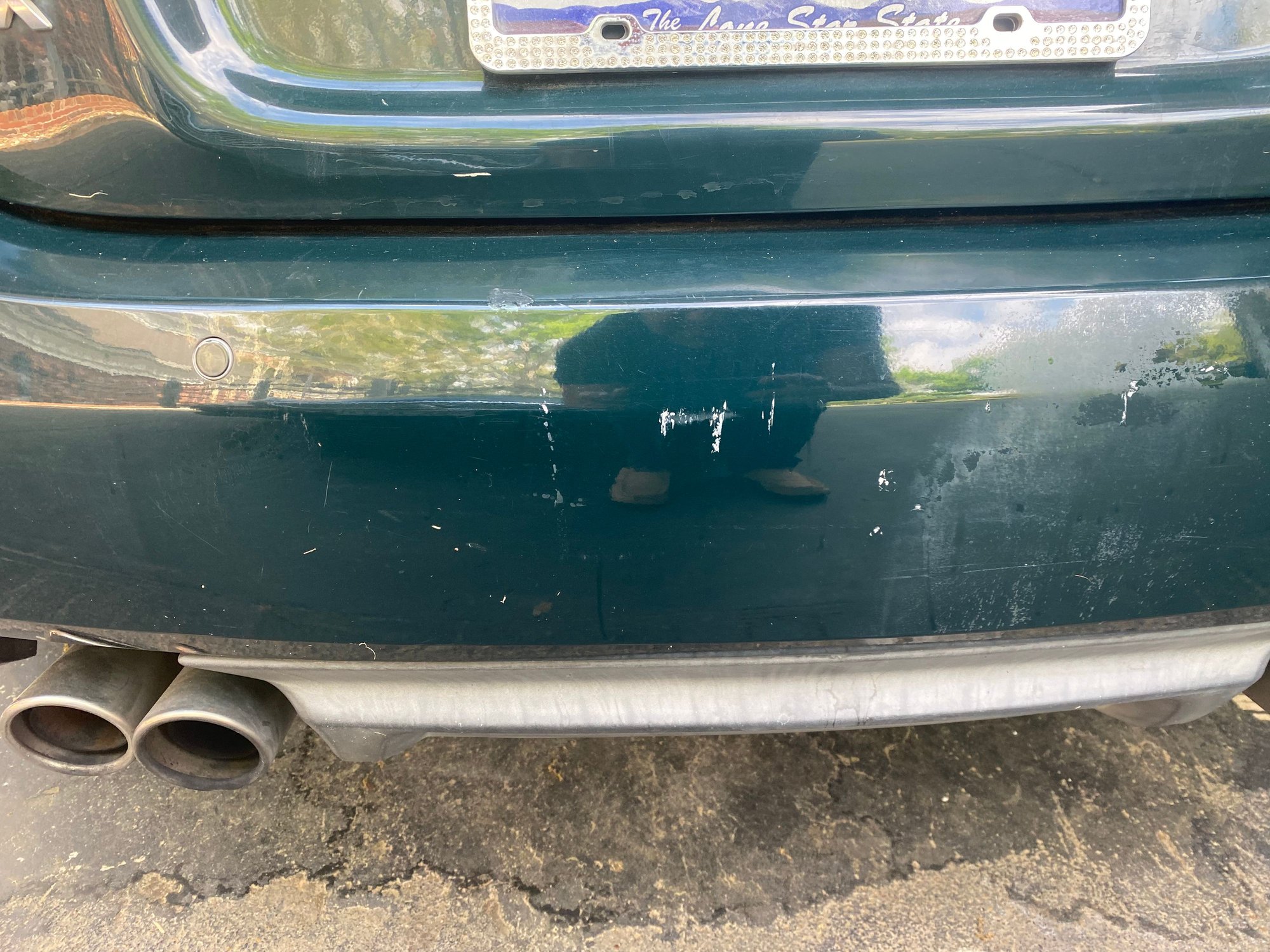

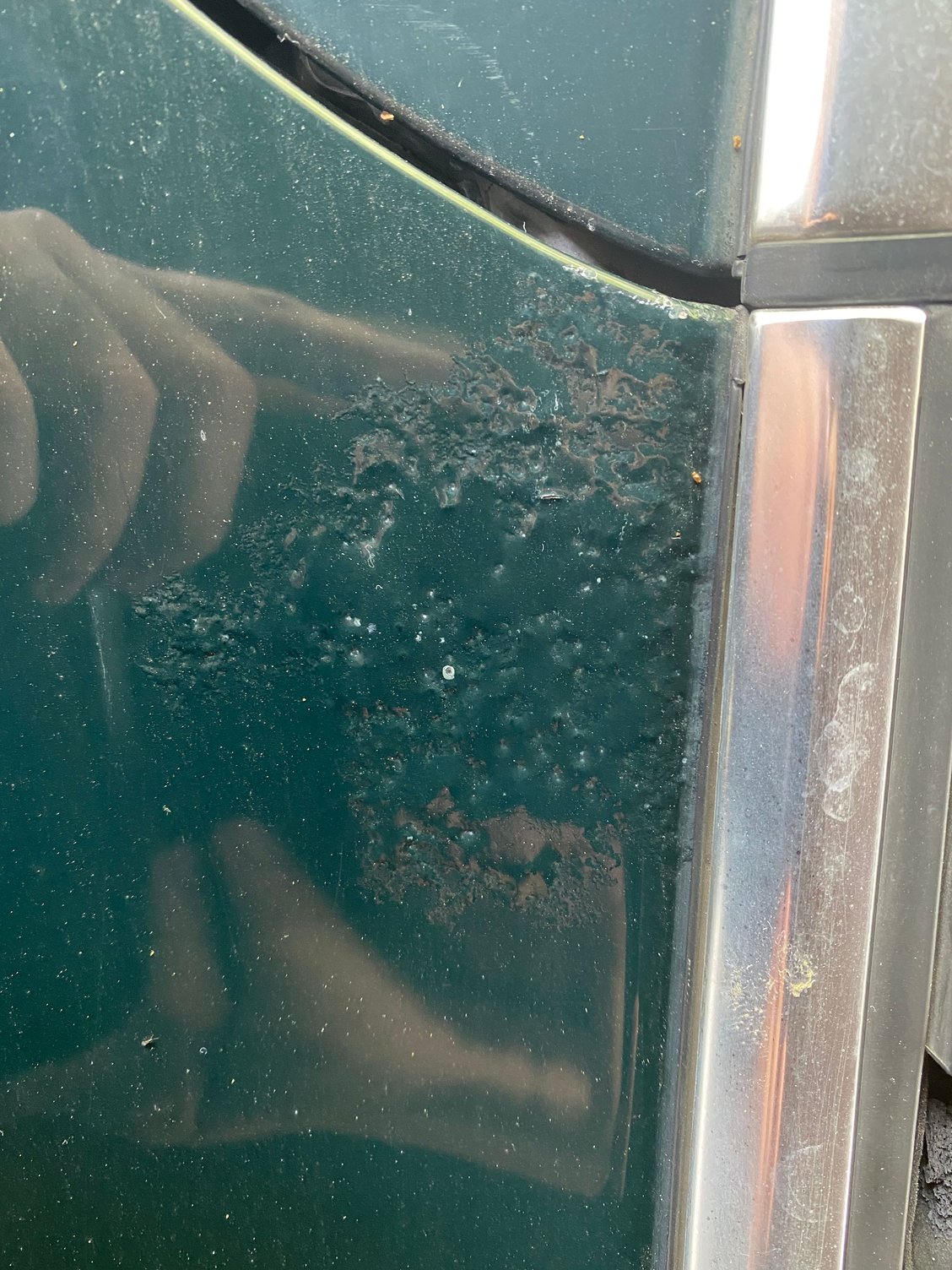

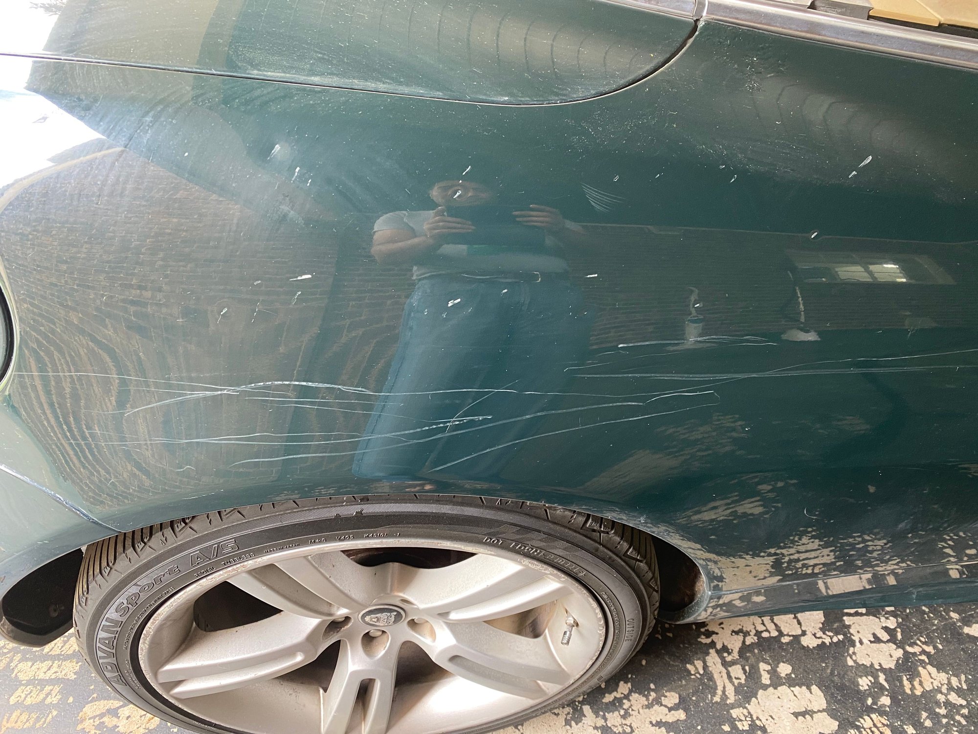

So I bought my 2007 XKR in 2010 when it had 20000 miles on it and 11 years later and at 140,000 miles ( not to mention my less than stellar car-care) the paint looks molested at a few locations .
I am attaching 3 pics of 3 diff areas of diff kind of damage and would be interested in hearing advise/reccos re how best to approach this
Blistering on the right side
Bumper chips / etc
Kids bicycle handles caused scratches

Some of the crap in the bottom two pics can MAYBE be buffed out. It'll leave some marks but be much better than it is.
The top pic you need to have some corrosion work done and then a partial respray.
Buff/polish the entire thing, you'll be surprised how good it'll come out (after it gets washed & clay-barred or micro-sponged).

Well there's the right way and then there's the easy way. The bubbles either need to be cut out and a new panel welded in or sand it then body filler and then sell the car. Next the side scratches. If they are through the clear coat you need to sand and prep the whole panel. The bumper cover just needs to be resprayed. Also after a complete inspection I'm sure you will find some other stuff. Matching the color will be another trick because it has dulled with age . Looking at the outside I question what the inside and undercarriage looks like. So my net is either respray the whole car (around $10K) or sell it or drive it until it dies.

I've been restoring classic cars for years but I don't own an X150 so can you tell me exactly where on the car that corrosion is? I'm trying to guess how it started because that's really what you have to address or it will come right back. I.e. was water getting in behind the panel somehow or is the paint cracked nearby or something?
A full body respray, done properly, will cost many thousands of dollars. But being that the car is not that old, you may be able to have only the damaged portions re-painted and the rest of the car treated to a paint correction process. There are a lot of videos on youtube by professional detailers pulling much older and worse neglected cars out of actual horse barns, polishing them, repainting a few bad spots, touching up of little nicks and scratches and showing astounding results. The cost in labor hours is still quite substantial but less than a whole new paint job. The choice is really where your own threshold falls, i.e. will you be happy with pretty darned good for $5,000 or do you go ahead and spend $10 grand and make it look like brand new again.

I think the problem started with my convertible top window separating from the fabric and letting rain water seep inside the panel . I will be happy with 'quite darned good" but was hoping i would be able to achieve that with about 2k . Have a budget of 5-6k for repairing/restoration of the car and out of that 2k will go towards replacing a seat and upholstery and 2k towards new top leaving 2k for paint work ( for now ).

3M has a three step process the body shops use called "Perfect It". Pick it up at any automotive paint supply shop, they will sell you three different buffing pads one for each step. This and a variable speed buffer (I use a Dewalt less than $200.00) will give you outstanding results even with paint in the worst of conditions. This is an easy DIY project that will put a grin on your face for years to come for the price of a dinner for two at an upscale steak joint. It's not magic and some of your scratches/corrosion are a wee bit too deep but the rest of the car will respond beyond belief.

Please: from where on the car is the first pic?
I do not understand the corrosion there, isn´t the car body made of Aluminium??

it’s not really corrosion , it’s what’s called ‘blistering ‘ of the paint … can be caused by poor repainting , painting under the sun or ( as was prob in my case ), water seeping in panel
...... caused by corrosion of the aluminum.
Sure, it ain't rust, but it sure is corroded. The paint wouldn't blister otherwise. Aluminum gives off a white-powdery substance when it corrodes. Evidently water got underneath the paint.
