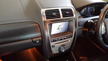

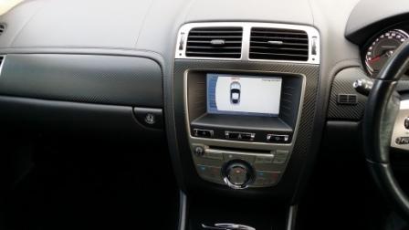

I'd try a good car polish on it - eg meguars (sp?). But if that doesn't work, you could always wrap the part. The black 3M wrap is pretty much identical to the piano black finish. Or you could go with something more funky. I just rewrapped mine in black carbon fibre (another 3M product) whichlooks very swish. It even has my wife's unguarded approval, and she has way more class and taste than me.

here you go. A trap for the unwary - figure out which way the stripes are going to go before you put the wrap on. I had to redo some of mine, but settled on them going to the left from the centre console and to the left, and to the right for the dash piece and right door.

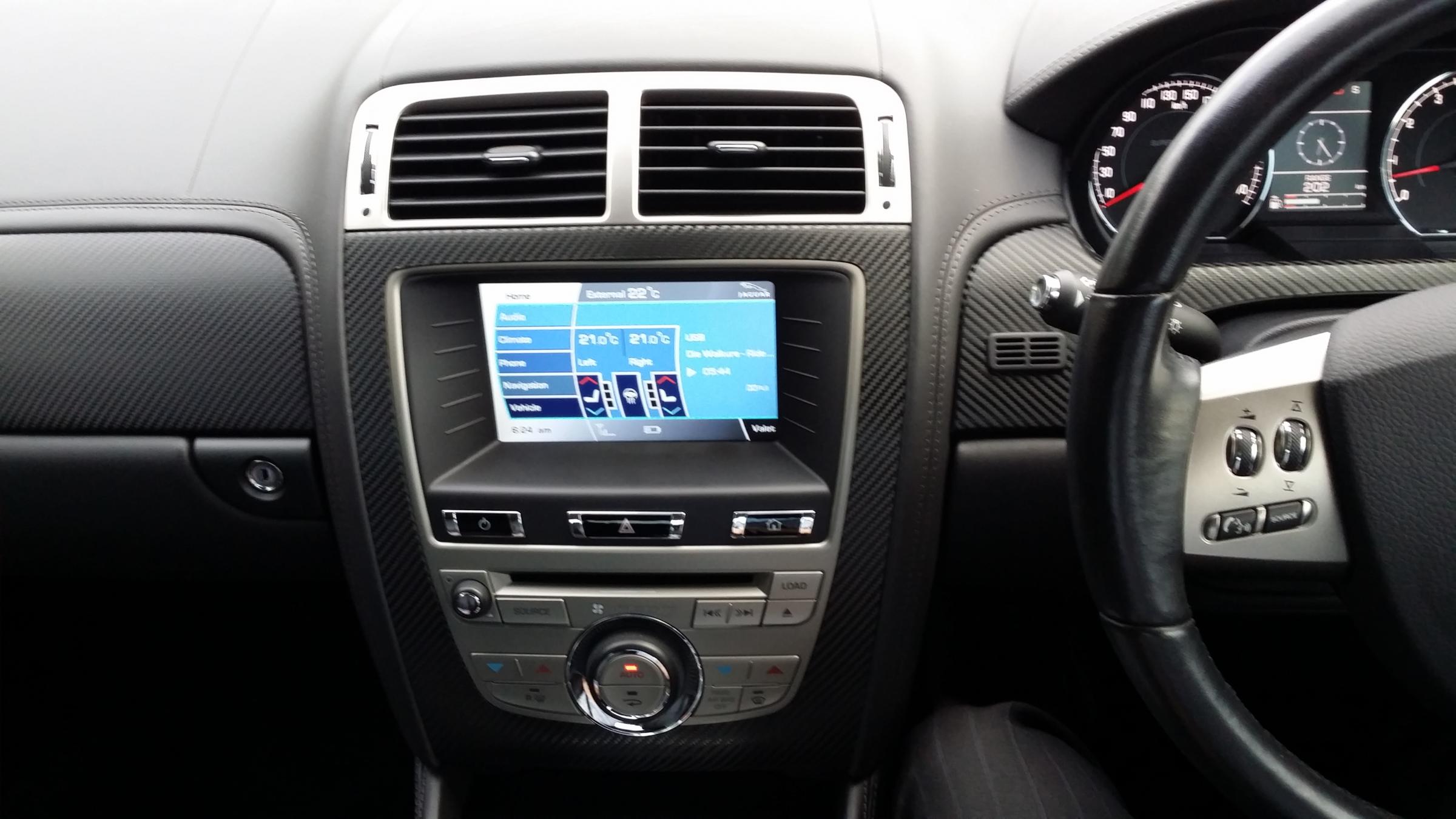

Strewth those pics look crappy compressed. This might be a bit better

It looks great though.
