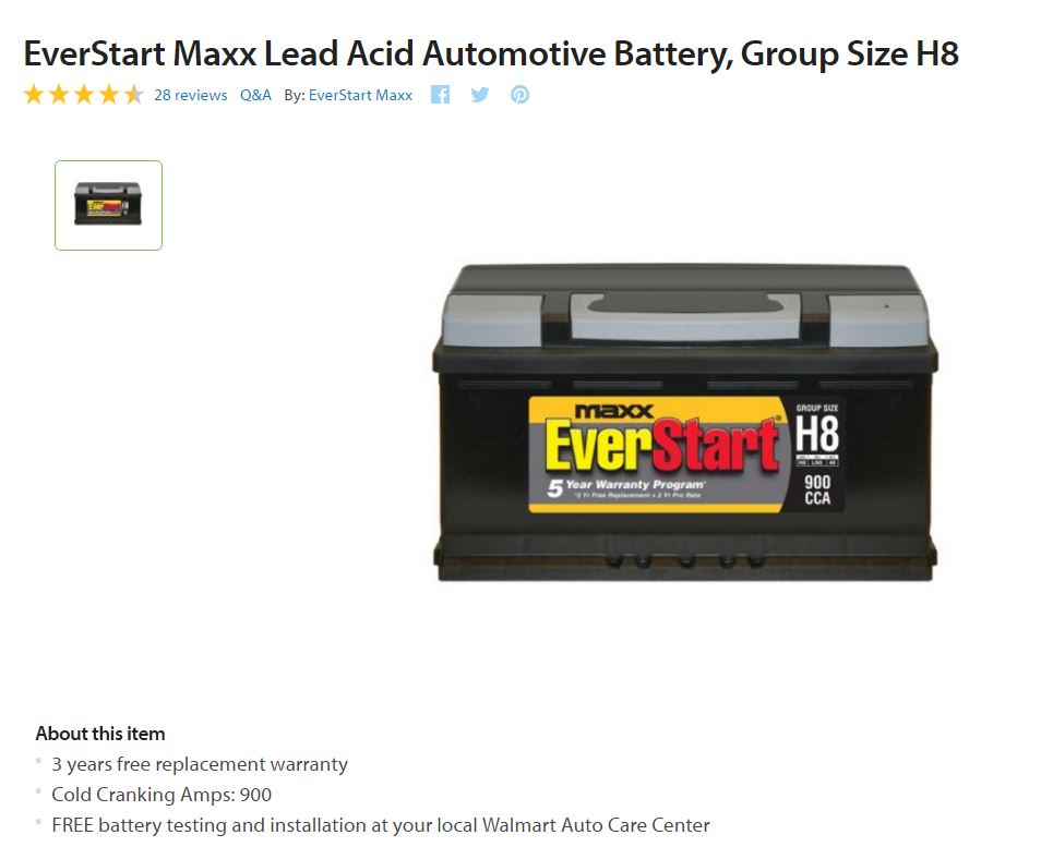

I did not buy an AGM battery. I bought a regular battery from Walmart, made by Johnson Controls who also makes the Diehard, Duralast, Interstate, EverstartMax, Optima and many other leading branded batteries.
Group49/H8 $122.00 .....900 CCA, Vented, 3-year free replacement warranty.
I use a CTEK MUS 4.3 on 4 of my 5 vehicles. The CTEK is connected 100% of the time when the cars are parked in the garage.
Yes, the CTEK will make the batteries last much more than normal. The CTEK's are one of the best accessories I bought for the XKR and my other sports cars.

Refer to post #8 above and click the image to enlarge. This is the exact battery that went into the 2009 Jag XKR...a perfect fit. Group 49/H8 w/ vent on left side.
Interstate dealer wanted $195.00 for the same battery under the Interstate brand made by Johnson Controls, Inc.
