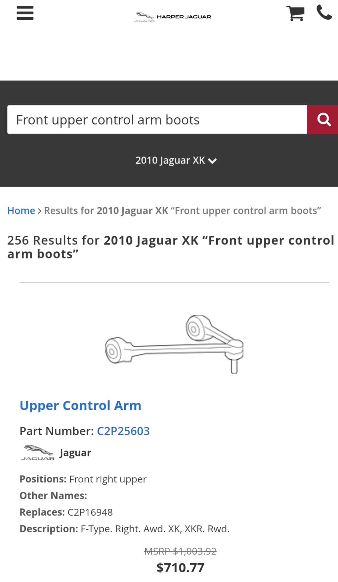

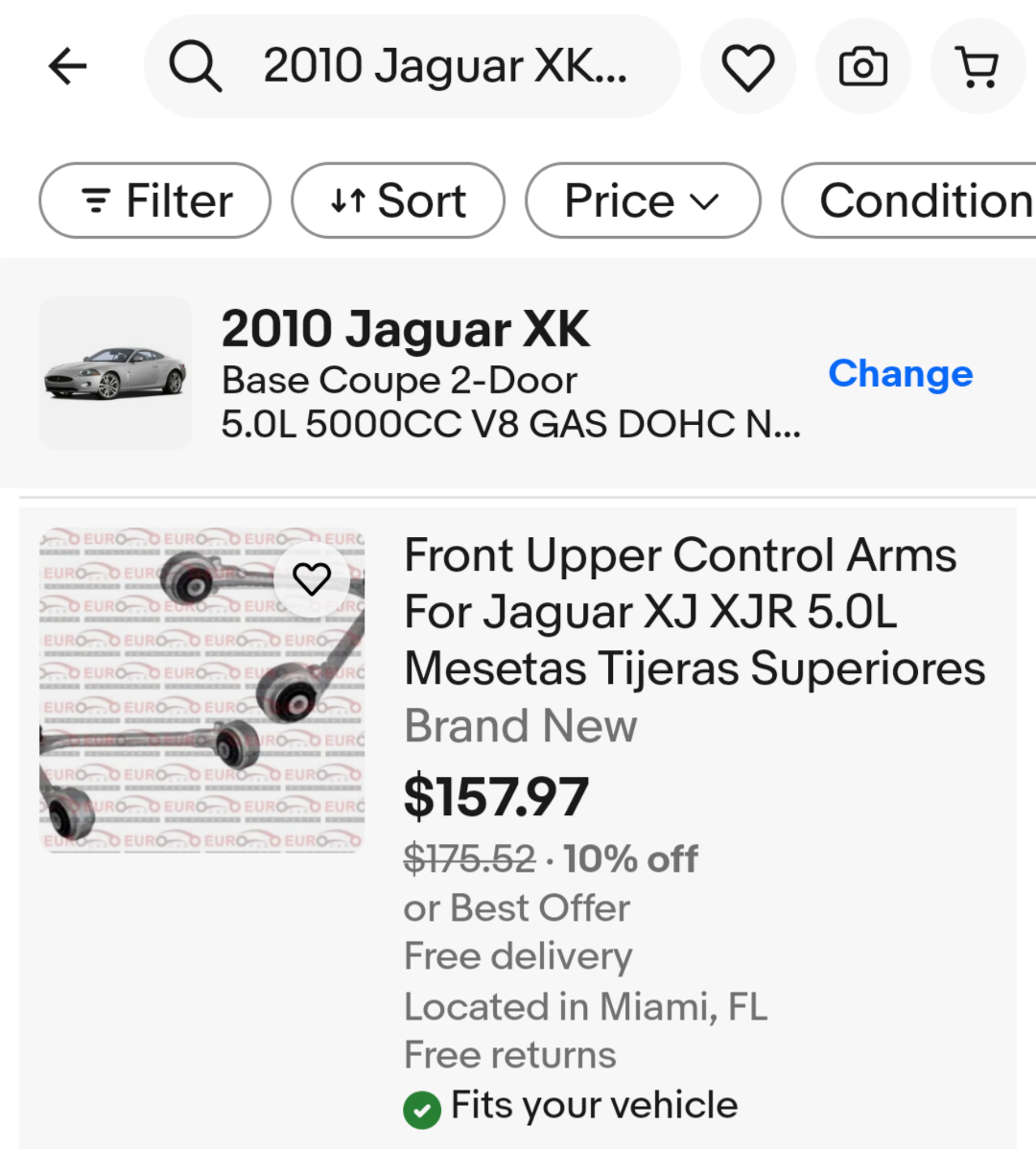

@bocatrip What you wrote doesn't make sense to me. You're asking about boots and described "... specs of 13-30-23mm is the closest I can come to 13-30-22mm however they are rubber ...". Those specs appear to be for control arm bushings.
Jaguar does not offer control arm bushings because they don't repair worn parts; they only replace them with new parts. A new OEM Jaguar control arm assembly includes a new rubber bushing.
T
That's the price for one. You'll need two, right and left. That's outrageously expensive.compared to the price of a pair on eBay:
At the risk of sounding like a broken record, I'll say it again, Sam: Your car, your money, and your choice. Why pay more?
