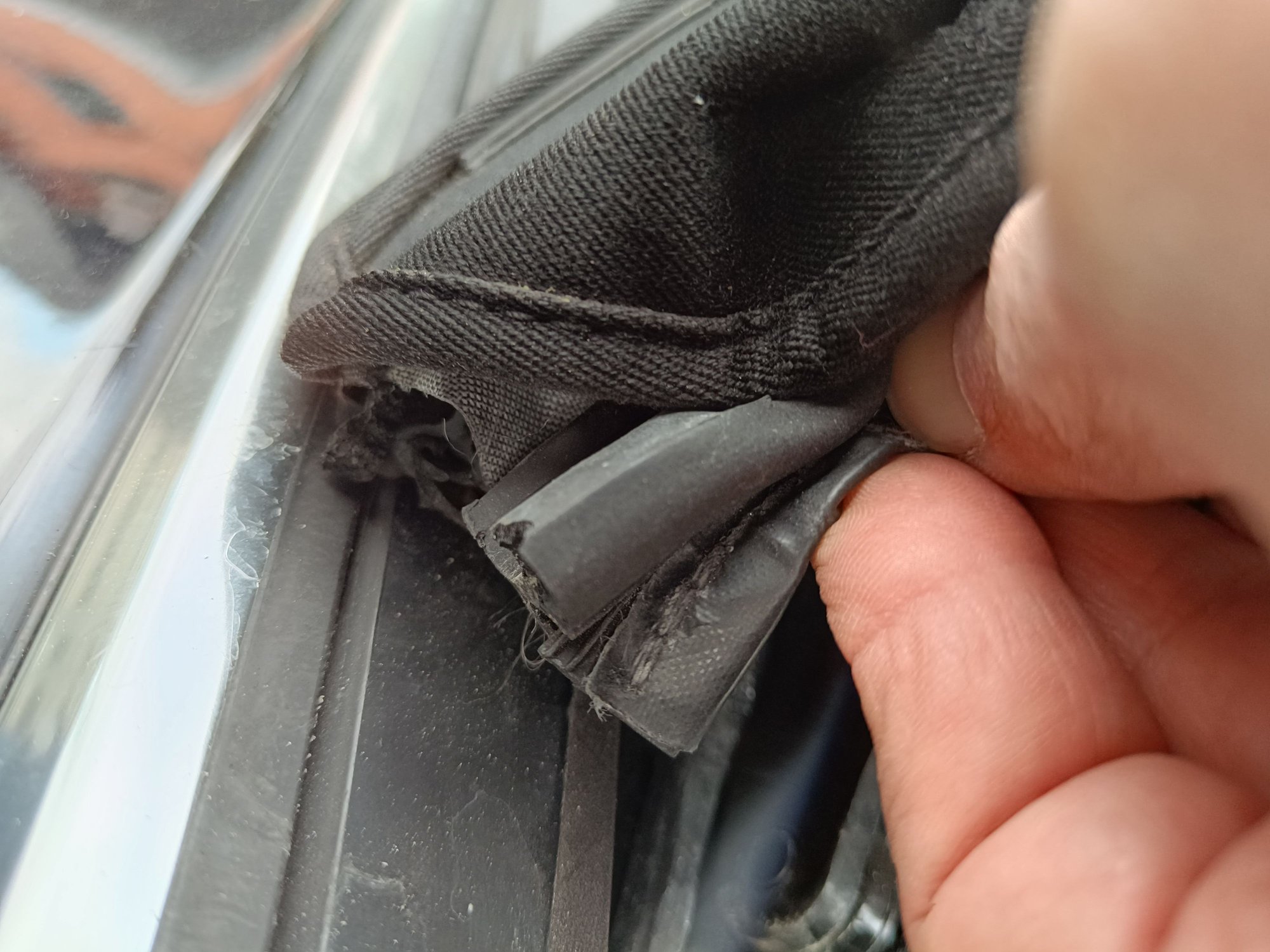

Old Oct 4, 2024 | 07:19 AM
earny's Avatar
Joined: Nov 2012
Posts: 220
Likes: 140
From: Cologne Germany
Sorry for bringing up this old topic again, bit I did not find a newer and my recently purchased XK convertible has the described problem: the weatherstrip around and under the back of the top is broken and in two pieces. Now there is a gap an both sides under the top at the side and causes loud wind- and road noise (plus a little rain also coming in).
Unfortunately the old link/pictures do not work anymore. Here is the situation of my car:
Is C2P16667 the correct number for a new strip?
https://parts.jaguarcary.com/oem-par...strip-c2p16667
And where are those mentioned rivets ("holding the top")? Does the complete top needs to be removed to install a new weatherstrip - hopefully not?
Thx in andvance from Cologne! Bernd.

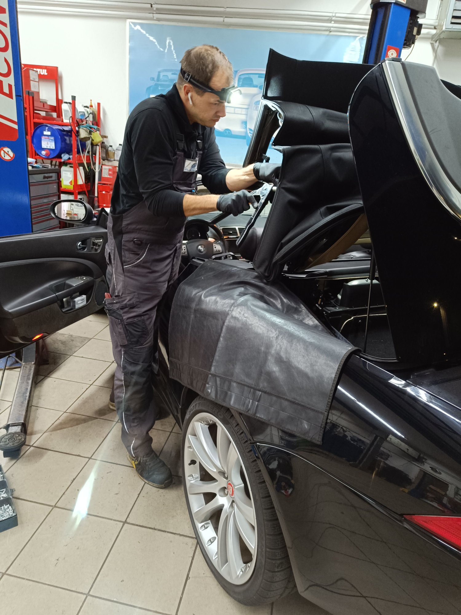

Old Oct 30, 2024 | 08:33 AM
earny's Avatar
Joined: Nov 2012
Posts: 220
Likes: 140
Just a quick answer in case someone will have the same problem with the split weatherstrip of the roof. The according to Jaguar "convertible top rear panel lower weather strip" was available and has indeed part number C2P16667. Price here in Germany a little under 200Euros.
Change is described in the manual available in te stickies. The only chalenge is to drill out 3 rivets and install them again with the new relatively tight rubber weatherstrip. The rest is self explanatory and the weatherstrip is - besides the metal holder with the 3 rivets - fixed under the roof with a metal "carrier" with some 20 T20 torx bolts. Took my mechanic about 1,5 hours without hurry.
And ready again:
