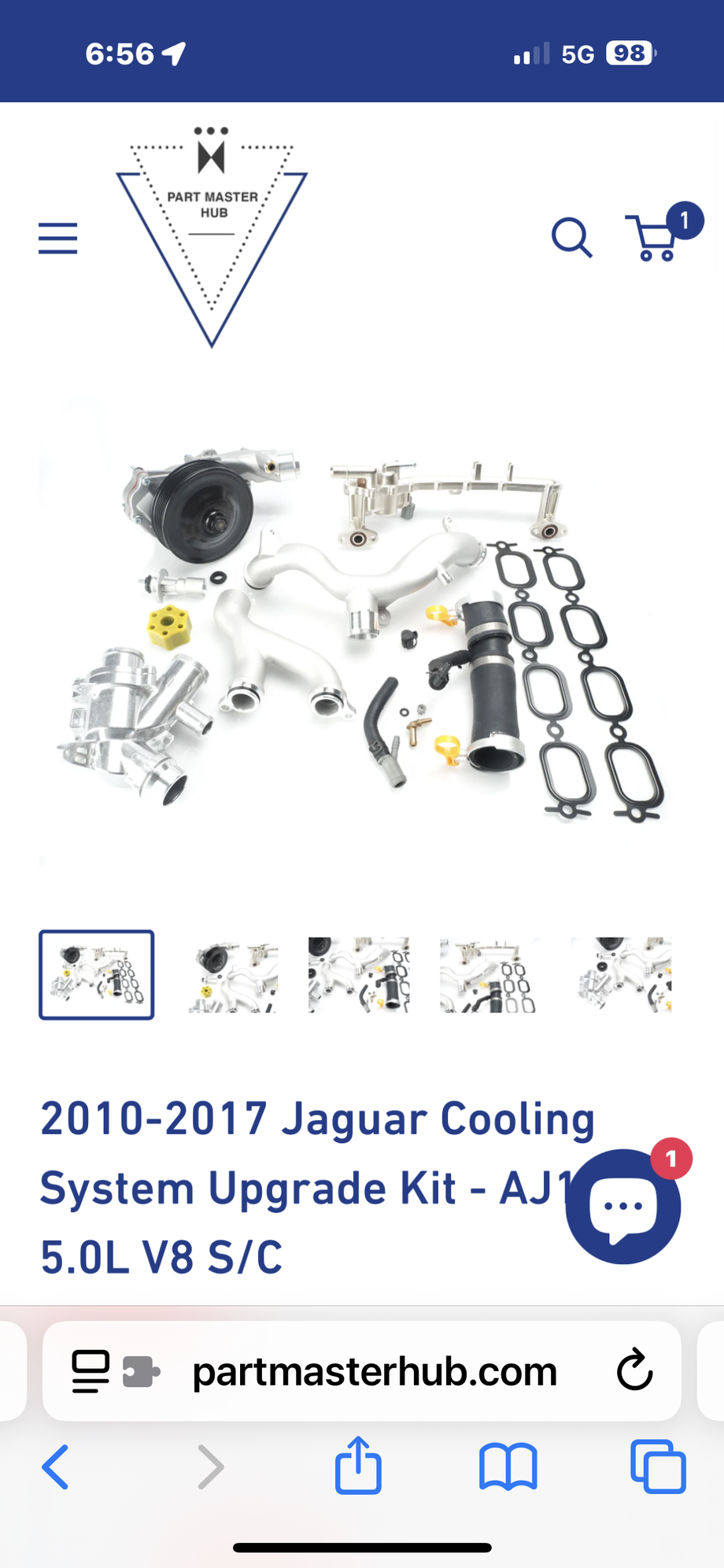

5. Upgrade the entire cooling system? Saw a whole kit for $396… (See picture below) or does someone have a list of better parts individually or what should I upgrade and what is useless? Just trying to eliminate future issues.
