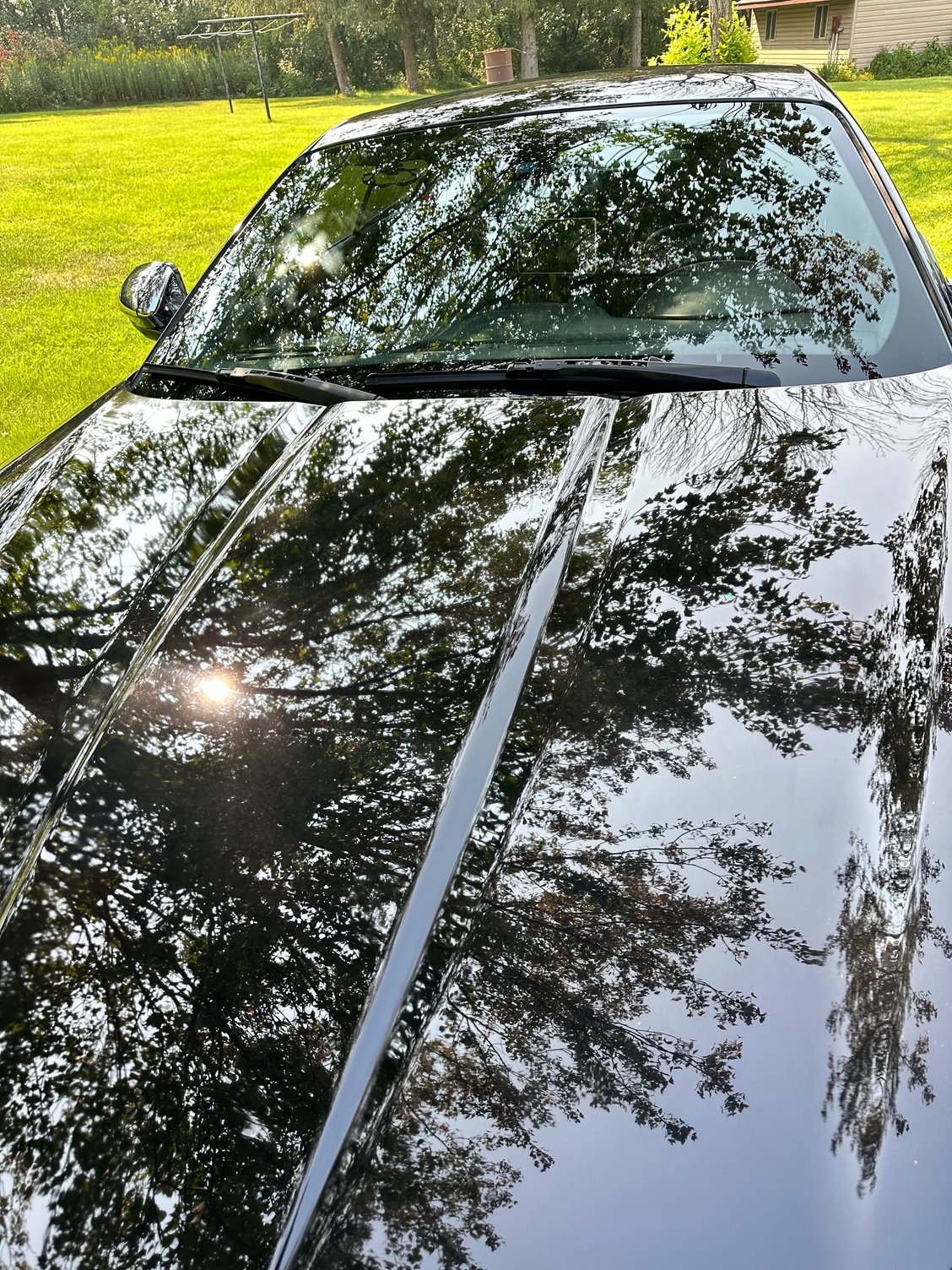

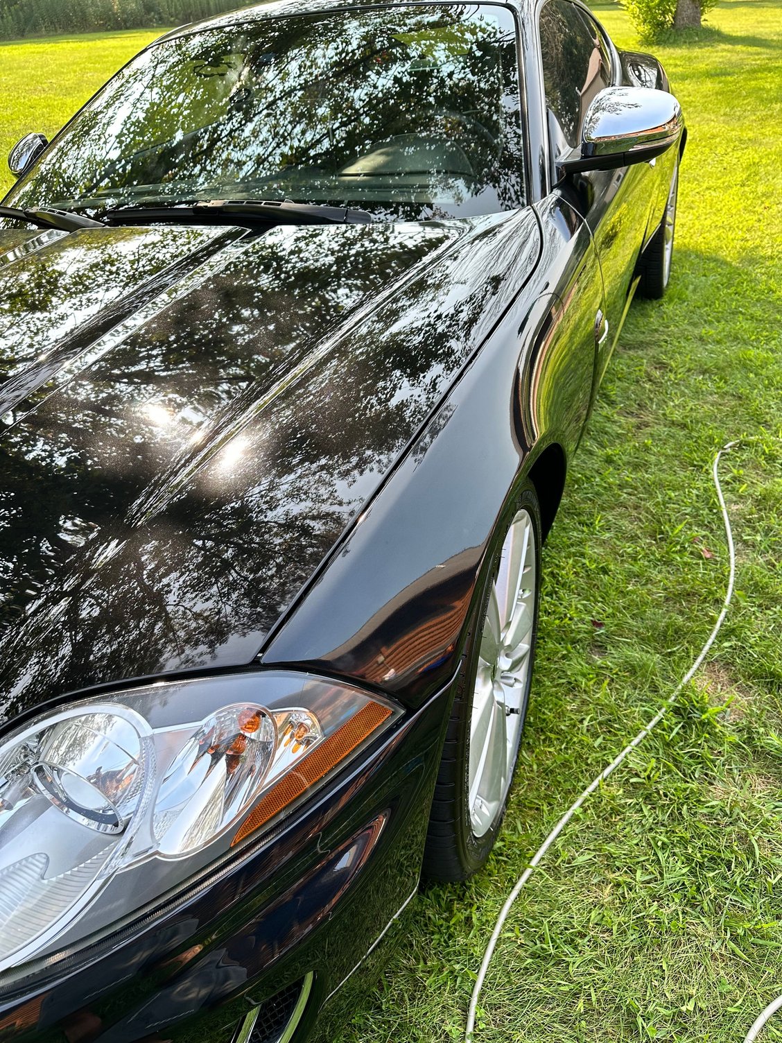

Originally Posted by Matusco
This is like an all in one.. You will never get a top coat scratch out using this product. I remember correctly the scratch was enough to catch your nail?.. You're going to want to fill that scratch using Clear Coat and a tiny applicator which is provided in the kits..
Do you own a DA polisher?... I purchased the SPTA on Amazon it comes with everything to get started in the Paint correction world.. I consider myself above intermediate as I've been doing for a year now and a ton of studying and using different products.. You don't need to spend 3-500 on a RUPES pro DA polisher, I have a couple and find that the SPTA is perfect for any task.. And the pads are color coordinated for uses..
Chemical Guys has some great Compounds I would suggest a Heavy, Med. and then a Polish to finalize..
I did some chips in my hood and you would never know they were there.. Watch DIY videos on YouTube.. There's some excellent videos on your exact situation...
https://a.co/d/1Wgios5
microfiber pads cut nicely wool is the best cut!!!
https://a.co/d/2LULRkg
https://a.co/d/3pgKLaY
This is the hood now...
