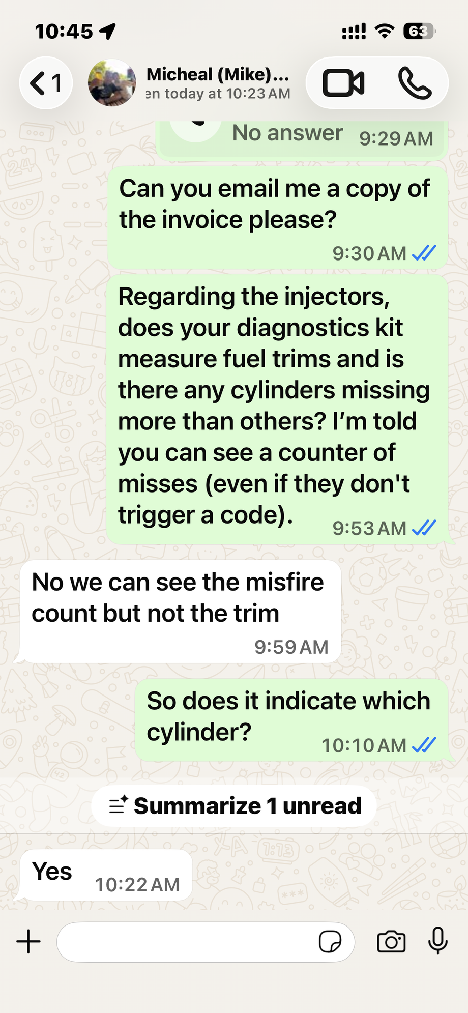

This sounds like the start of injector failure - most things I've read show slow degradation and then a sudden failure of fuel dumping into a cylinder. Especially black tips and poor MPG. Definitely do cheap/free diagnostics first like swapping coil packs but you may be in for replacing a bank of injectors at least.
What's your fuel trims like and is there any cylinders missing more than others? Usually you can see a counter of misses (even if they don't trigger a code).

Thank you LJR today they say they they want to replace 4 injectors not sure if they are all on the same bank until I get to talk to them.

So this is the text string regarding injectors.what questions do I need to ask if any? If they identified which cylinder then why do I need 4 injectors, is that legit?

I start my own thread as my 08 XKR had a rough idle and after warming up was fine I suspected a leaking fuel pressure damper. With great help from this form and a decent diagnostic tool and firing the parts cannon as someone put it at my car I have this down to cylinder 4 misfire, I notice if I rev it currently I can get odd misses on others. I have done the plugs all new with quad electrode racing plugs, coil packs, I will replace lamda and O2 sensors, I have them just not done it, but suspect injector on that one. The cost of injectors though is eye watering, I have had advice from independents and injector specialist that are not trying to sell injectors that you do not replace 1 injector.
The issue is if you replace 1 it will be off balance with the others especially due to the remaining having age, wear and tear and build up on them so you have a choice. replace all 8 or the other is to have all 8 removed and send them off to be sonically cleaned, tested and balanced. If you replace the one then later on you may have to replace another and another etc on the 4.2 SC its not going to be fund riping of the SC and manifolds every so often. So I am preparing myself for a big costly job but the outcome would be thousands of miles of driving afterwards. The cost of a clean, test and balance here is ?22 per injector, then you need the seal kits and clips at ?15 x8.

It's like what Jaguar!2 is saying above, it's more cost effective and worthwhile to replace all 4 on a bank at a time since the amount of labour to do it is so high. If one is failing and they are all the same age/mileage, you're gambling on the rest if you only replace one.
