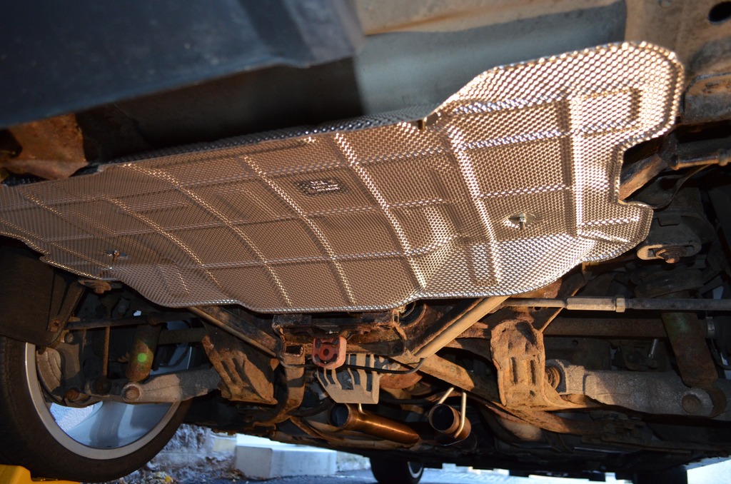

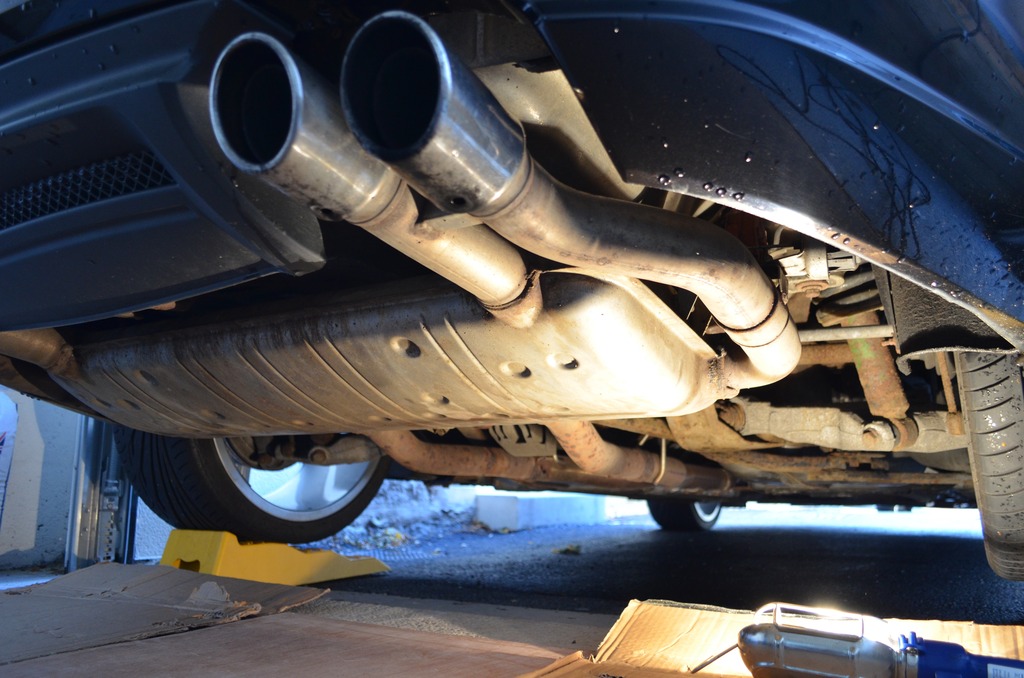

Originally Posted by 8bit
My car is a 4.2 XKR but here goes:
Standard "back box" still on:
Attachment 151776
And off, just requires bolts to the middle section pipes undone and hangers popped out of the rubber mounts:
Attachment 151777
New heatshield in place (old one had vanished somewhere along the line):
Attachment 151778
New box in place, refitting is the reverse of removal:
Attachment 151779
Lovely pipes, they didn't stay clean for long though:
Attachment 151780
Attachment 151781
First start!
Jaguar XKR - Spires Stage 1 + Elite RR back box - First Start - YouTube
And some revs:
Jaguar XKR - Spires Stage 1 + Elite RR back box - YouTube
That's the Elite RR rear silencer, already have the Spires "Stage 1" middle section with resonator deletes and a X-pipe.
