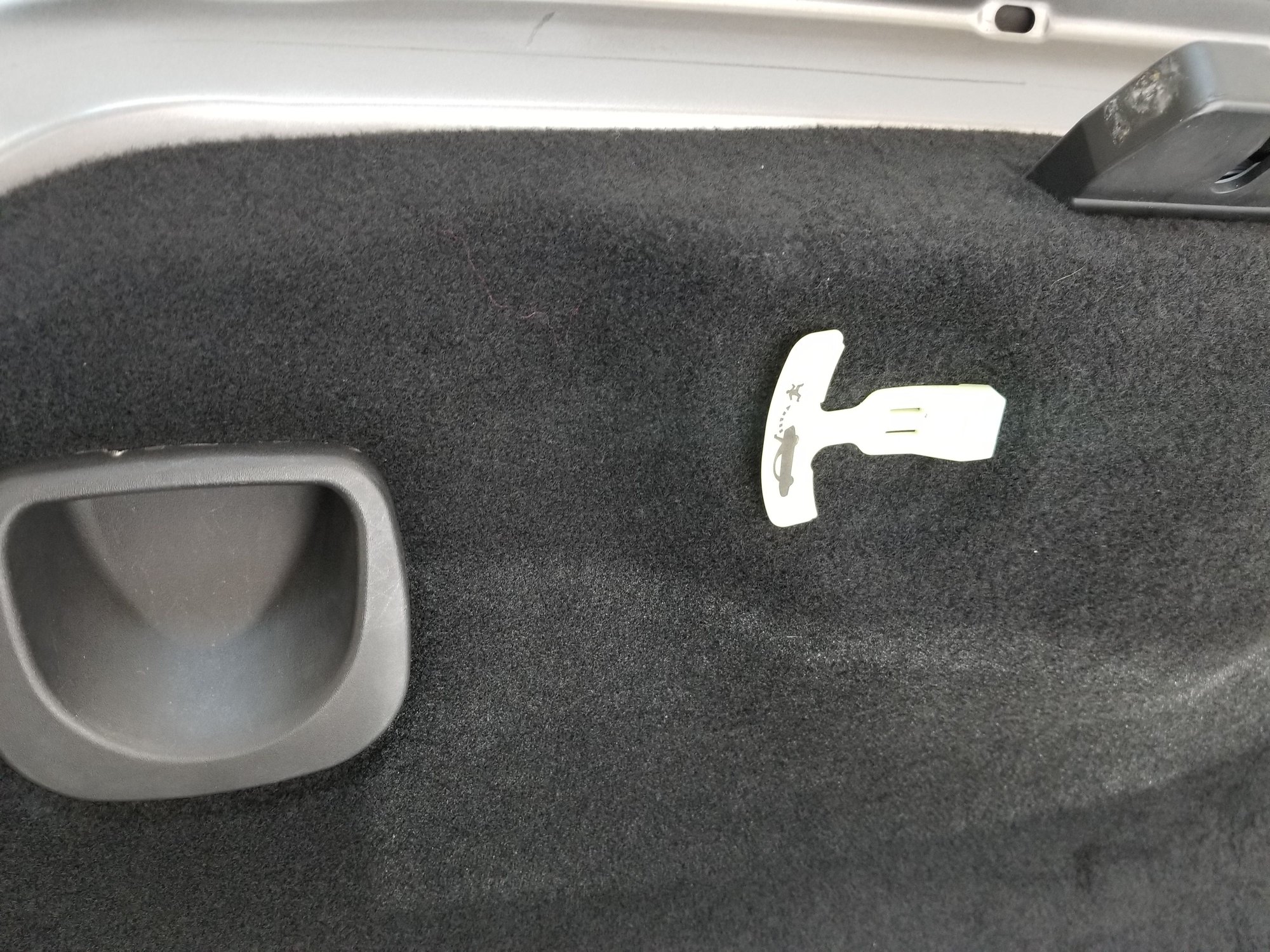

You mention the emergency hatch release, so i wondered, have I got one of them to release the trunk on my convertible? if so, where please?
Old Nov 22, 2021 | 10:36 AM
fxdwg's Avatar
Joined: Oct 2020
Posts: 184
Likes: 136
From: Oklahoma, USA
You have one. It should be a yellow handle that's attached to the lid. Open the trunk (rear compartment) and look inside the lid.
Old Nov 22, 2021 | 12:37 PM
Stuart S's Avatar
Posts: 10,124
Likes: 7,127
From: Atlanta suburbs

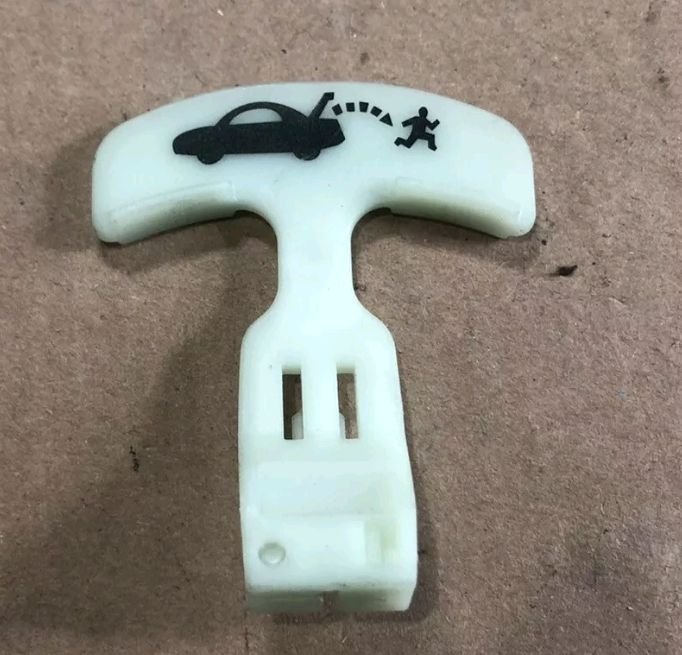

Here's mine.
It fits snugly into the lid and doesn't fall out when you slam it closed. It glows in the dark and is required by Federal law in the USA to protect children from being trapped in the trunk. https://one.nhtsa.gov/Driving+Safety...nk+Entrapment/
If yours is missing or damaged, the OEM Jaguar part number is C2P3676, and it's still available from your Jaguar dealer for a King's ransom. I accidentally broke mine and bought a used, like-new handle on Ebay for $15 delivered. It's actually a Ford part from a 2012 Ford Focus, but the identical handle was used on many other Ford vehicles.

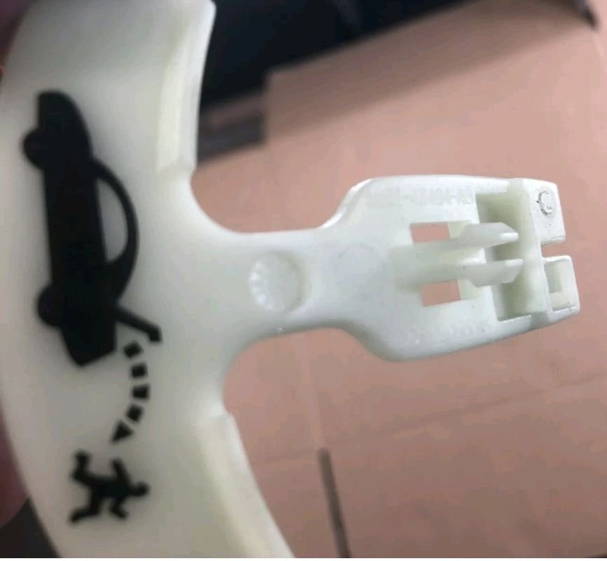

Installation is easy. Use small locking pliers to pull the wire cable out as far as possible - maybe 2 inches - to remove the old handle. Using a paper clip, push out the round pin in the bottom left corner of this photo and remove the wire.
Note how the cable comes out because you'll put the new handle on the same way.
Here are more pictures so you'll be able to know exactly what to look for on Ebay, since Ford made several slightly different designs.

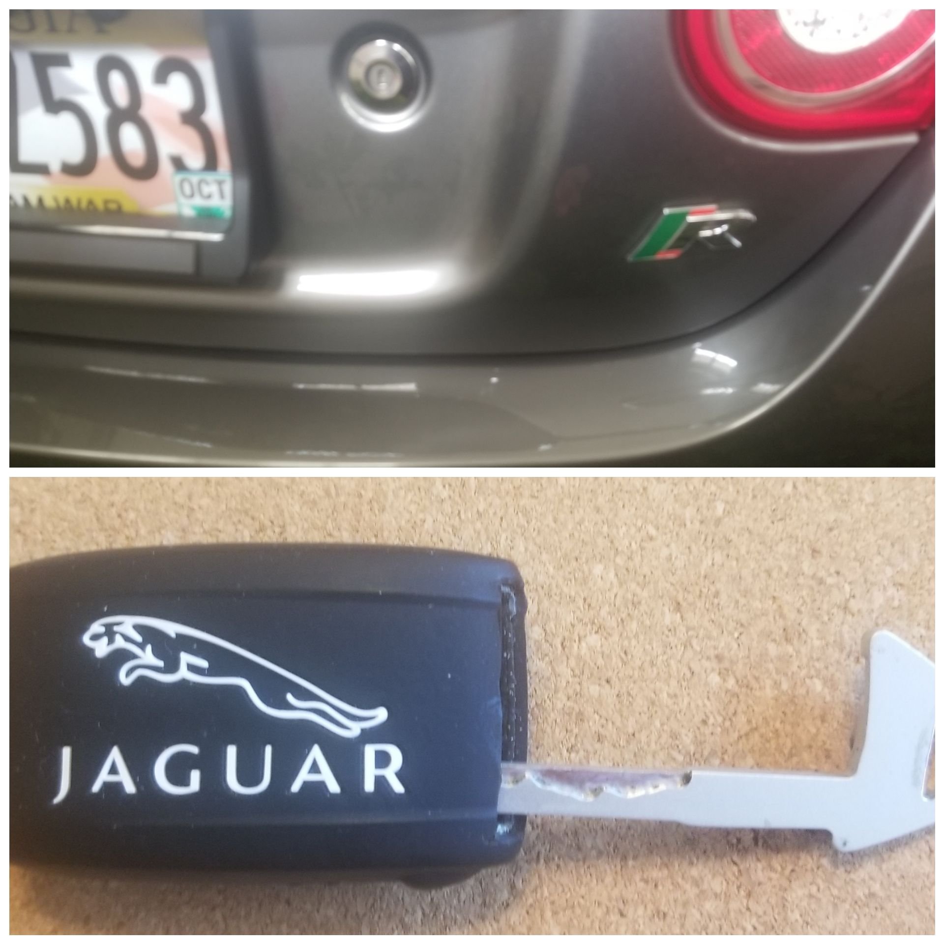

If you're unable to open the boot using the switch on the dashboard or wirelessly using the Smartkey fob, don't worry. The boot opens from the outside with the Emergency Key that is in the Smartkey fob. That key also unlocks and locks the doors.
European license plates are wider and cover the boot lock. Simply remove the license plate to access the lock.

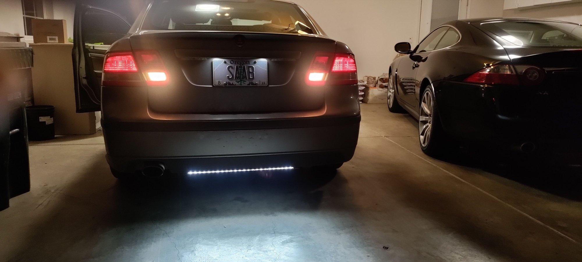

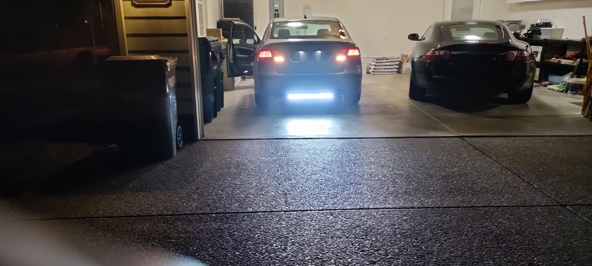

Hi Dave: I empathize! I just got a "new" 2007 XK 4.2 and discovered the same thing. I have been a Saab owner for 3 decades -- depending on whether it is a US or an EU car a bulb is installed in one side but not the other. I like the symmetry so installed both -- BUT -- you cannot do that in the Jag.
The Saab back-up lights leave a lot to be desired so I installed an LED strip on the back bumper -- I plan to do the same to the XK.
I like the idea of buying another EU light -- in my case I would make it a fog light and simply install an LED strip floodlight under the back bumper for a backup.

Originally Posted by Kiaorana
... I like the idea of buying another EU light -- in my case I would make it a fog light and simply install an LED strip floodlight under the back bumper for a backup.
Adding lights that change the resistance in a circuit can trigger a "bulb out" warning on your dashboard.
