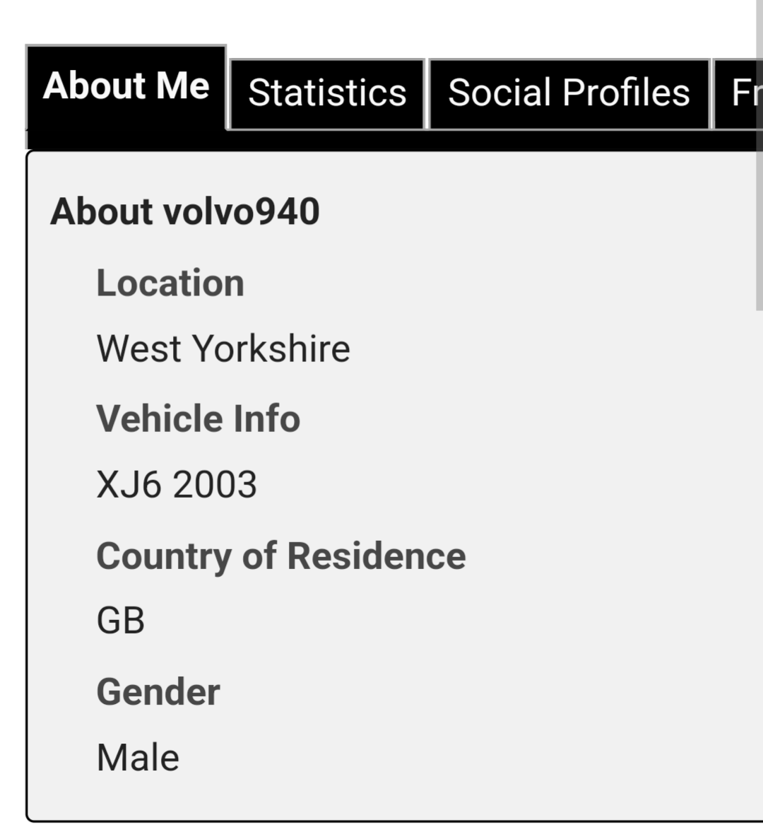

My advice is to post your inquiry in the proper forum for your car or correct your Public Profile.

I noted that @volvo940 edited his Post #1 to inform us that he has a 4.2L 2008 XK.
