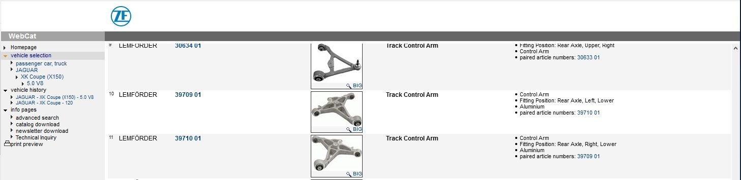

I've always replaced the arm rather than rebush but that is personal preference. Quicker solutions and there's always a risk pressing a new bushing into an old aluminium arm.
The OEM suspension arms are manufactured for JLR by LEMFÖRDER. who also list replacement bushings:
https://webcat.zf.com/?SPR=4
Here in the UK we can source LEMFÖRDER from aftermarket parts distributors at a considerable saving over JLR prices. If you lookup the LEMFÖRDER part numbers you may be able to do the same. This is an example for my XK:
