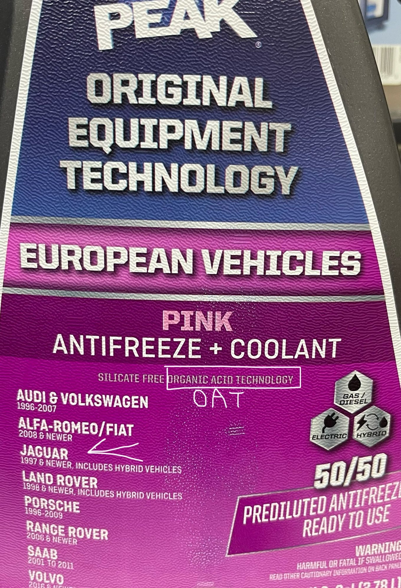

The coolant used on Jaguars since 1996 is OAT. It's sold in both orange and pink.
"The color of coolant is simply dye and provides no function or distinction between coolant types. However, OEMs use different dye colors for specific vehicles to convince customers that they need to buy OEM-approved coolants."
ASTM D3306 is the standard for passenger cars. Your bottle should say both ASTM D3306 and must say OAT on the bottle. Not IAT, Not HOAT, Not OATS, Not "hey works like OAT." Some IAT coolants do come in pink or violet. They are inorganic and not to be mixed with OAT.
@Circumnavigator , if it were me, I would match OAT and color. Once you flush the coolant system, you can use any type of coolant you want, so long as you do a complete flush. When I last did my flush, I went with Dexcool. Dexcool, which is often confused as a type of coolant is merely a specific brand name of OAT coolant. Prior to that, the original owner had pink OEM coolant per the maintenance records.
Also, let me know how the mirror is mounted please. I may have been thinking about my wife's last car.
The mirror is about 4th on my list of easy knockout stuff. But I will take pics and post when I do it.
Here is what I bought. It was above the MIN line, but I removed the cap and topped it to the internal MAX spot.
