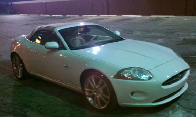

Hello, I was just about to send an email to see how the process was coming... congratulations.. just in time for summer....post a video.... when the product is ready for sale i'll be one of the first customers.
Attached Thumbnails Remote and one-touch convertible top control works!!!!!!!!!!-img_0329.jpg
