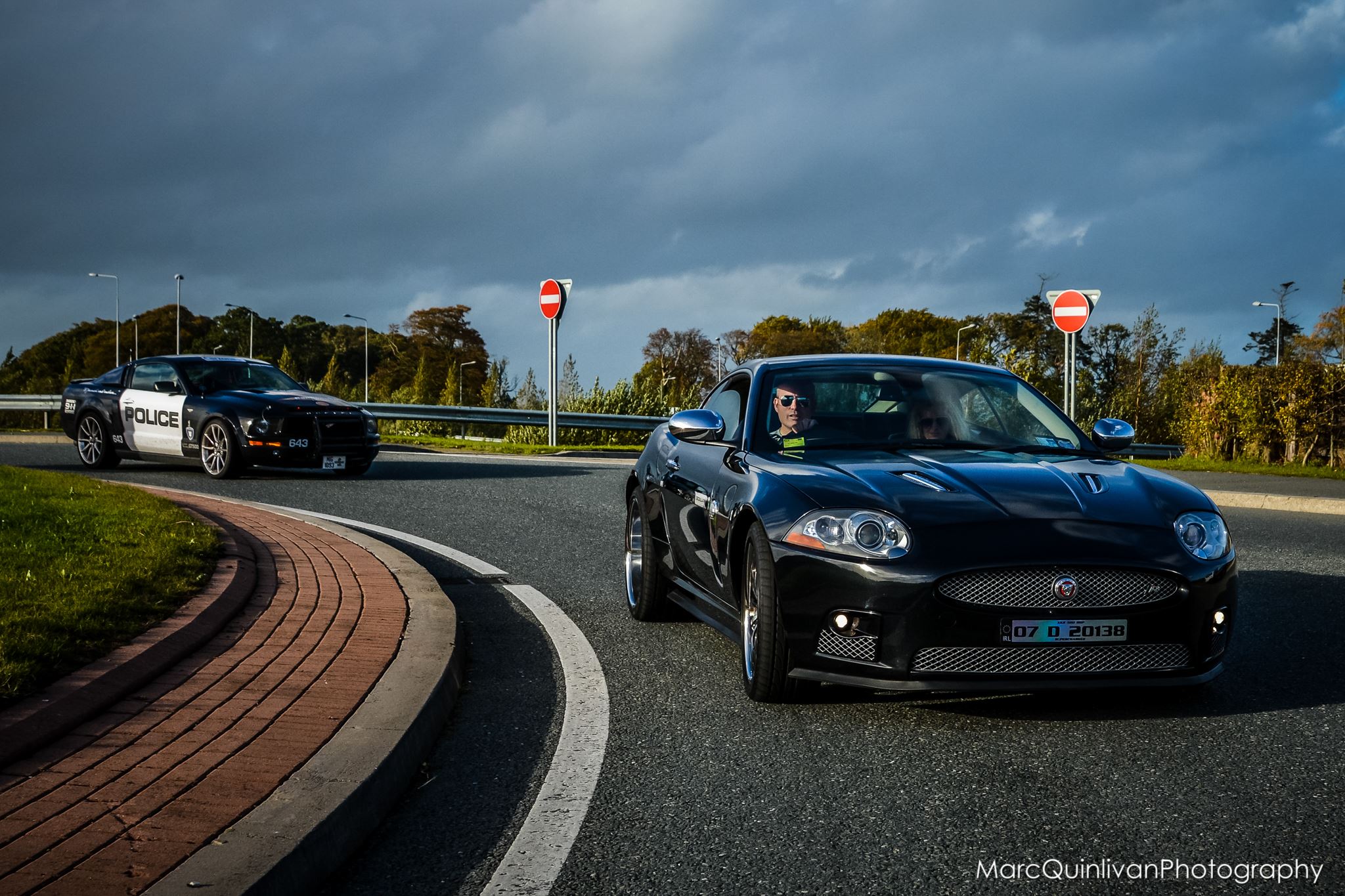

Lukeeeee, i have a 2007 xkr and love it. Had the old xk8 for 6 years then traded for the xkr. Have it nearly a year now and apart from small minor issues ,i wouldn't part with it, if it is a good deal and mechanically sound, you'll love it.
Just a few pics of mine,
I have a post up called,
Some Exhaust noises you might like, if you would like to view, my car can be seen in the videos, nice noise.
Attached Thumbnails Seeking advice on buying used XK-cannonball-4.jpg   Seeking advice on buying used XK-pamerstown3.jpg   Seeking advice on buying used XK-nice-arse.jpg   Seeking advice on buying used XK-dsc_0066.jpg   Seeking advice on buying used XK-dsc_0081.jpg
