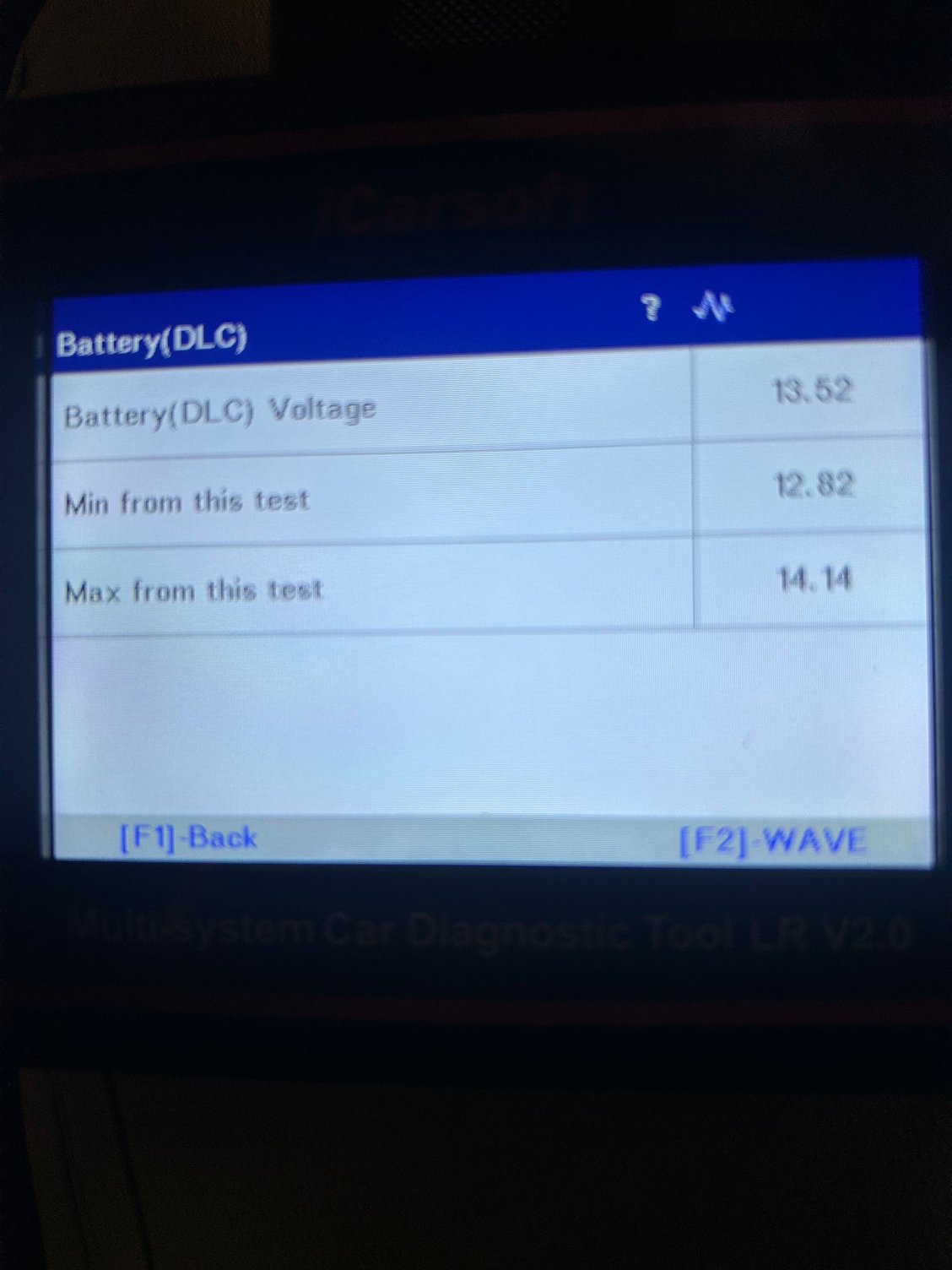

I hooked up the scanner with the car at idle and this is the voltage test, no ac or lights or screen on. Does this suggest alternator is on the way out?

that looks good to me

looks like your alternator is doing it's job but if I can ask, why are you at the shop?

Find a new shop, changing the Alternator isn't trivial on a XK, certainly not when it's working fine

The centre screen started continually rebooting again and they wanted to try a hard reset. That seemed to do the job and I asked them to check the battery status which is when they came up with the alternator starting to be on its way out. Think I will hold off on that until I get some other things done first!

@alanroberts50 Your 2013 XKR came from the factory with a Battery Monitoring System module attached to the negative (black) terminal of your battery. If a battery charger or battery maintainer was ever directly attached to that negative battery terminal, your BMS Module could be damaged. Also, damage to that BMS Module may have occured if you ever hooked up jumper cables to that negative battery terminal.
A bad BMS Module could be the cause of your problems. See this thread on how to reset it.
BMS reset
5.0L owners should always use a chassis ground. Never attach anything to the negative battery terminal. Doing so could brick your BMS module.
Stuart
P.S. I forgot to mention that most auto technicians are clueless about the BMS Module, unless they're Jaguar -trained. That module causes the alternator to behave kinda funky, which can lead a technician to believe that the alternator is defective when it isn't.

Guys, you're jumping on this alternator like it's something to check first. His output looks fine. He's not complaining of noise. He has a touchscreen that occasionally goes black. He should be testing the battery - must have done that because shop said he needs an alternator. Scan shows alternator output in his post. Makes little sense to chase the hardest and least likely cause first. He can simply use a bypass and check each module. Sure he could remove the alt belt and check the bearing but go for the easy stuff first. Let's try to save him some time and money.

The easiest way to see whether BMS + battery + alternator are working properly is to plug an eBay cigarette lighter socket voltmeter in and keep an eye on it as you drive.
The BMS behaviour means you will see "charging" voltage varies from 12.4 to 14.8. I've known it to remain at 12.4 for a couple of hours whilst BMS does a battery discharge test.
Like a smart battery charger voltage can read from 13.5 to 14.8 during "bulk charging", remain at 14.8 for desulfurication, but also runs an occasional battery capacity check by allowing a controlled discharge down to about 12.2.
Before knowing this, when I first read the charging voltage on a fully charged battery I was left thinking there's an alternator fault, as it read just 12.4 with the engine running.
The only way to properly appreciate how it works is to cast the occasional eye on the meter during a journey. For instance, BMS can increase the charging rate when you decelerate or brake and you will see the voltage increase.

There is every likelihood that your alternator is working just fine and in unison with the BMS🙂
