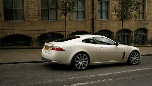

Always liked the rs-v by kahn they come in 20x9 front 20x11 rear
