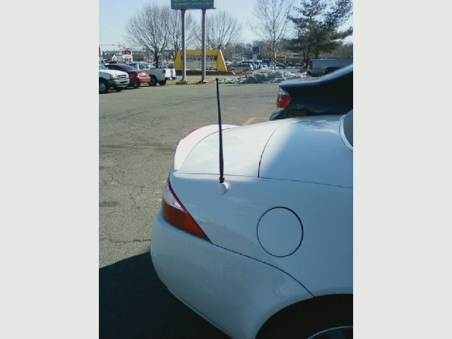

I'm taking my car to a local car audio shop tomorrow. They said there are a couple of antennas that might work ... I will update
UPDATE 28 January:
Found two local car audio shops who can do the install based on the photos and info from the Forum. Funny, one shop quoted me less than $200 for parts/installation, while the other shop quoted between $300-$500 for the exact same thing! I guess that's the difference between customer service and GREED. The install will happen next Saturday. I'll post pics.

Got the shorty antenna installed yesterday at Safe N Sound in Manassas, Va. for less than $125.00. They said the only complication was the bracket, which had to be custom made, so let that be a warning should you decide to get the work done. The antenna is nothing more than a universal antenna, which cost about $29.
