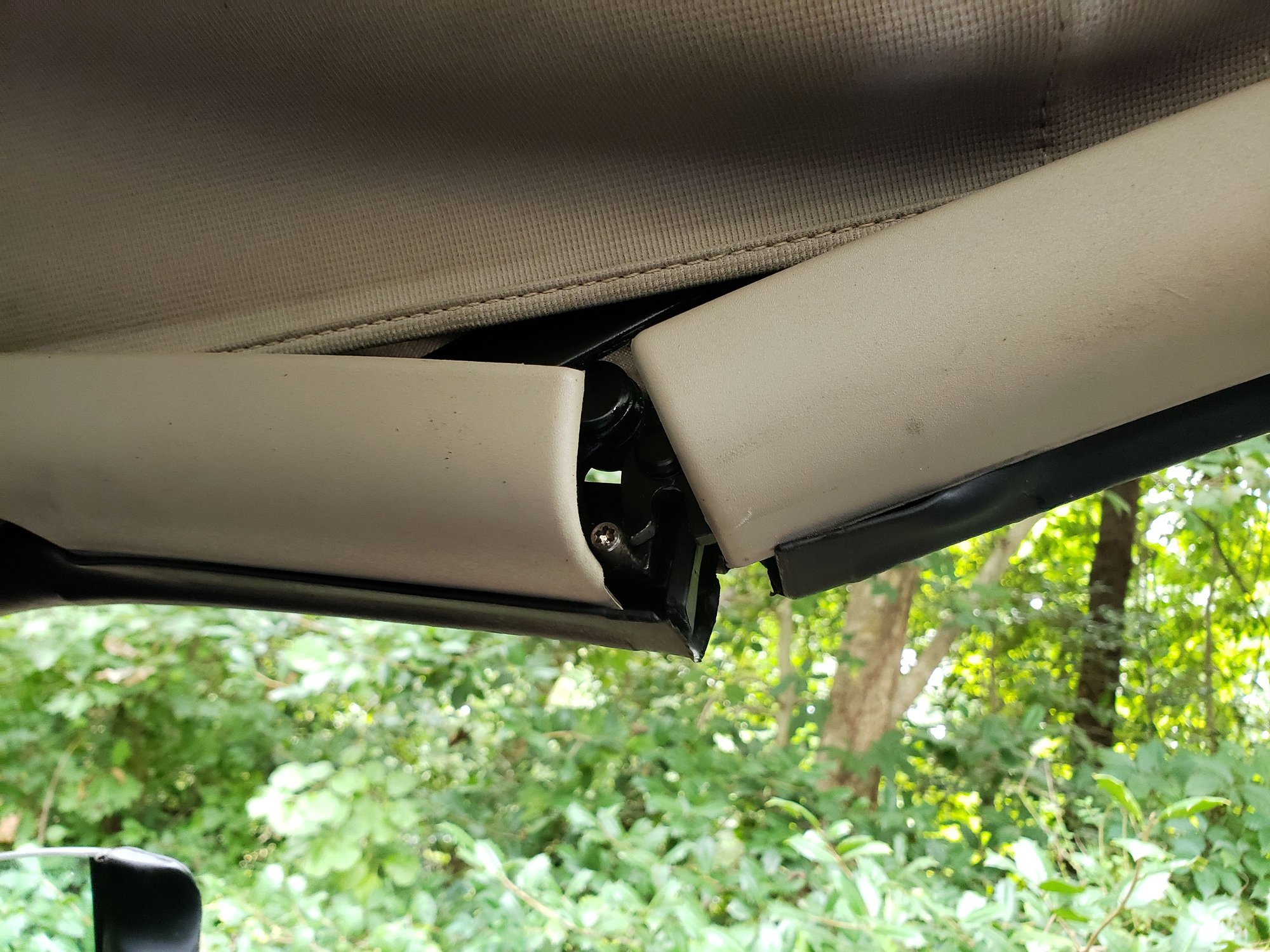

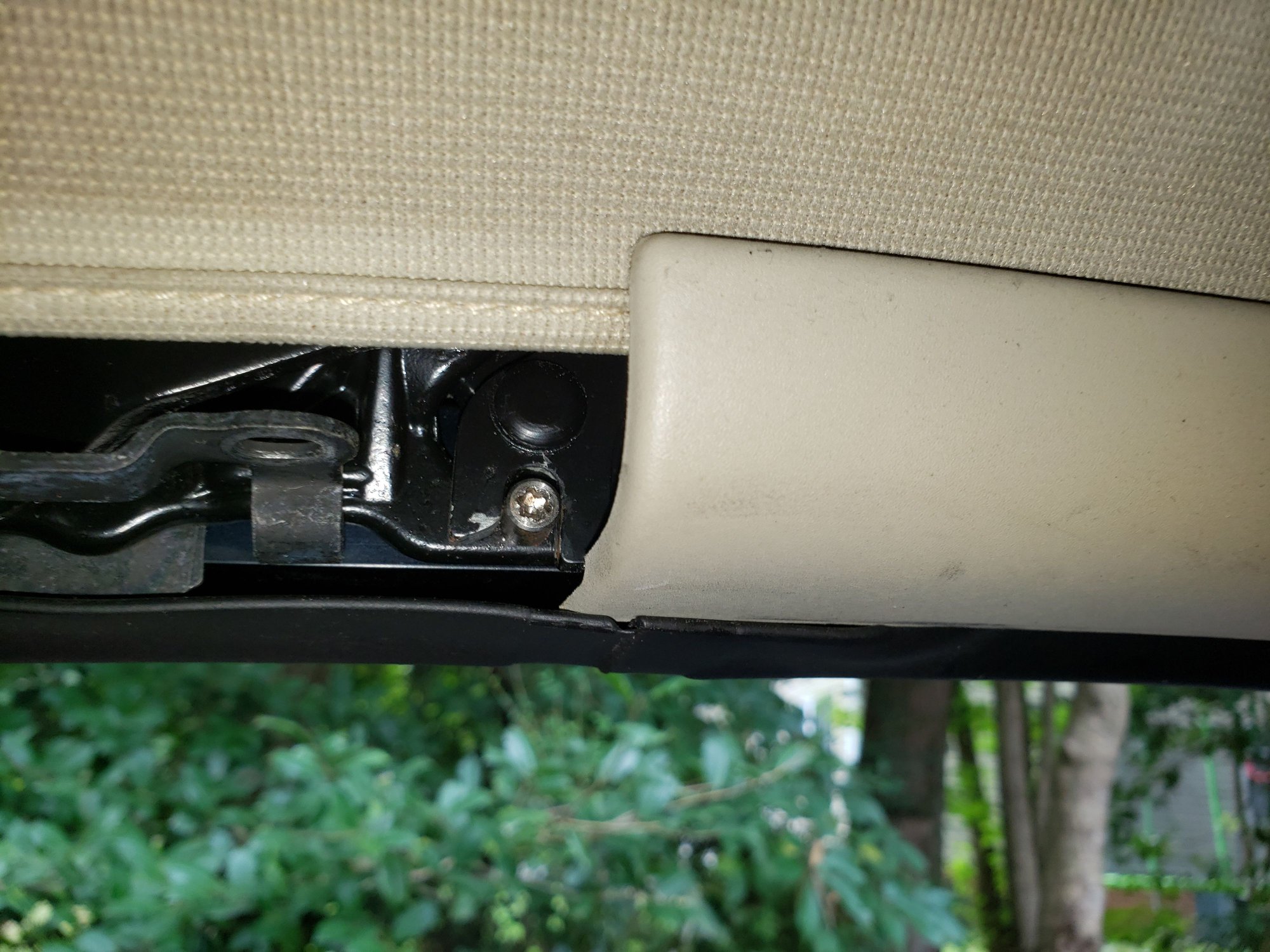

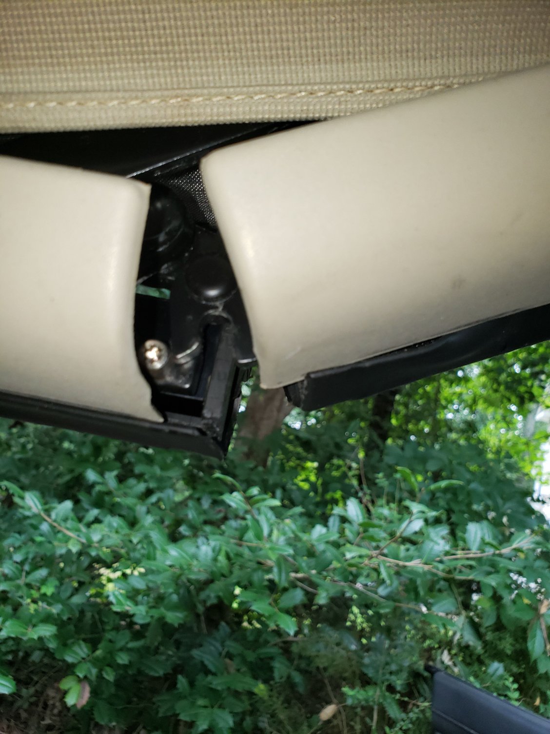

Discussing various XK issues with @gbellefo I suggested manual operation of the convertible top for a weekend excursion until parts arrive to make the needed repair for automated operation.
Not a stranger to manual "hood" operation myself, I was doing just that, positioning the rear window glass on a pair of edgewise nominal 6" deck boards to add sealant. A stitch in time, so to speak.
Since my oldest son is long since gone, I've become accustomed to doing things myself, a "one man show".
On this occasion, I manually released the front latch (seems like 50 turns of the Z-wrench), opened the bypass valve on the hydraulic pump, then lifted the front and rear of the "hood" simultaneously and, holding the rear up, placed the appropriately named "deck boards" to support the rear window glass. The "hood" was then suspended in mid-travel.
After the sealant was renewed, with time to cure, I removed the boards and went to close the "hood" only to find that that the front edge would not close to the windshield.
The convertible top, "hood", was somehow mechanically bound. I realized that I had seen the results of this problem before, on another XK, one with a "floppy hood" that when closing would fall by gravity as the front edge passed vertical. So, rather than "force it", I carefully examined the linkage.
Left side convertible fold point showing guide pin
Convertible top frame ahead of the guide pin
Slot in frame properly engaged with the guide pin
Apparently, lifting the top from one side can cause the frame to become skewed sufficiently to mis-align the guide pin on the opposite side. Forcing the top under these circumstances will bend the mechanism and cause a "floppy hood". The correct solution is to carefully examine both sides to determine which side is mis-aligned and lift the frame to clear.
Better yet, avoid the problem completely by having a helper on the far side when manually opening or closing the "hood".
