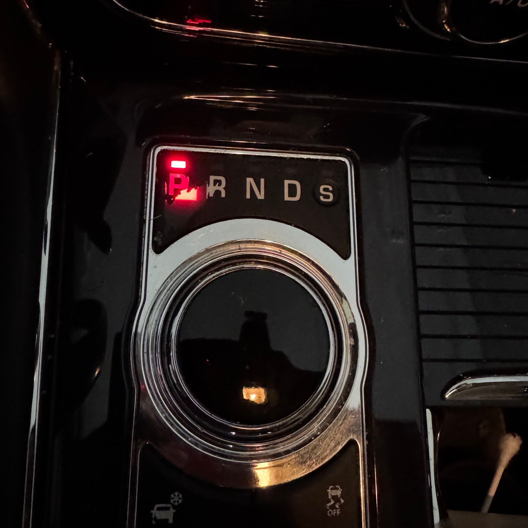

Default PRNDS decal came off with rubbing alcohol! Now what do I do??
Originally Posted by Bearly
I used simple rubbing alcohol to clean this residue off the buttons. It worked really well.
UGH!!! How do I replace this???
