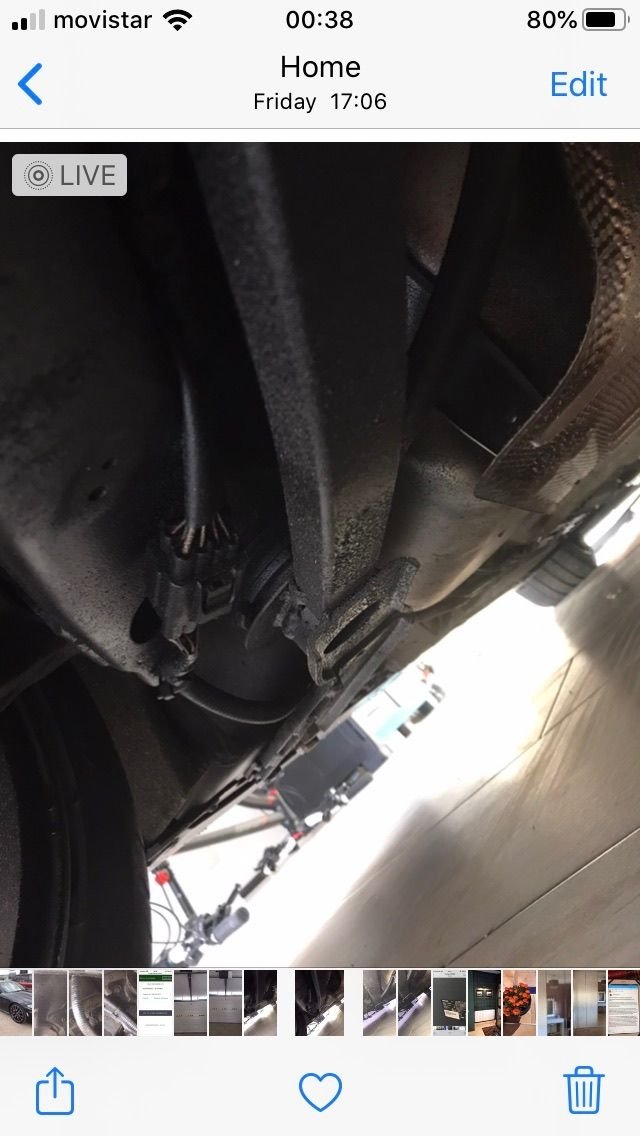

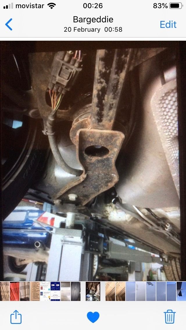

Car got brushed and waxed with Waxhoil-product can be found in Halfords UK.
Joining a pic ‘before’ and ‘after’.
No TSB for my car DGL but got told there has been issues with F-types.
Thank you for all the replies.
