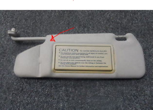

↑ Just because 'you' couldn't fix it, doesn't mean it can't be fixed. The notches that hold the visor in place are no longer working because the clamshell [sun visor] has separated a bit. (it's two pieces]
Try this experiment first. While you are folding the sun-visor back up to the roof, apply enough pressure with your other hand/fingers to hold the clamshell together [towards the edge where the bar passes through it-see my attached pic. That's where you need to put the pressure] You will notice that the sound goes away and it will stay in place.
Bottom line> you need to tighten up the clamshell. Solution: Simply drill a tiny hold through the sun-visor and put a small nut and bolt to hold it together. Done. Make sure you do not drill through any electric wires [visor light] and that you are putting the nut and bold at the best spot possible. You might want to remove it first to get a better idea of exactly where it needs to be. The pic I am posting here is a representation of where to put the nut and bolt but it might be different on your visor.
