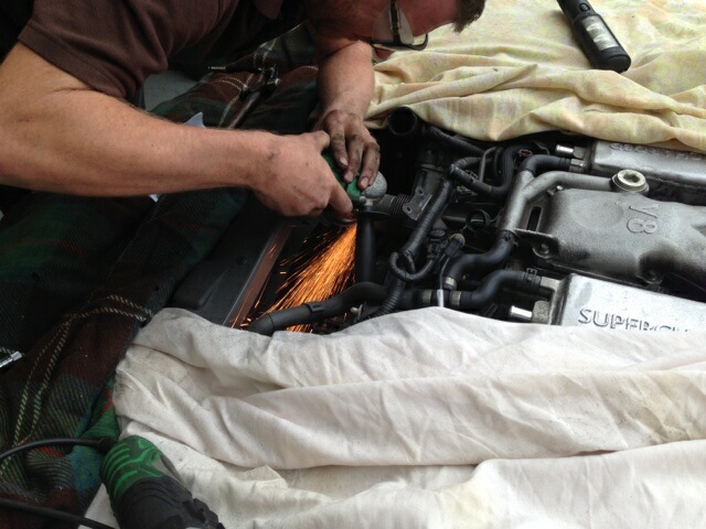

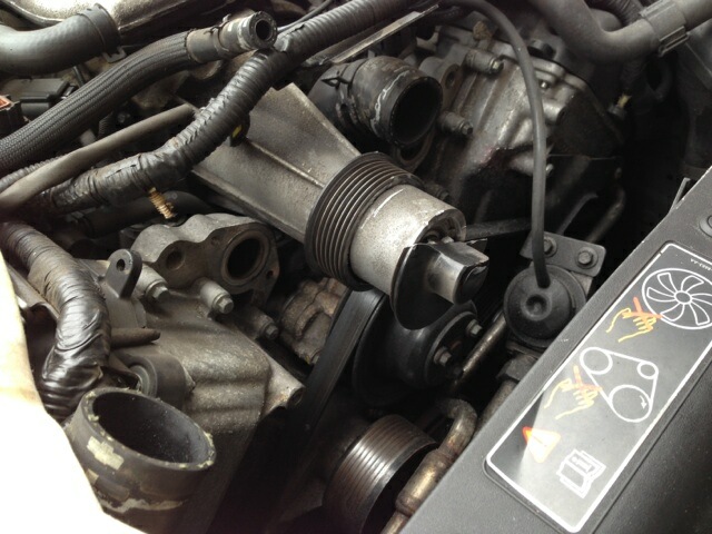

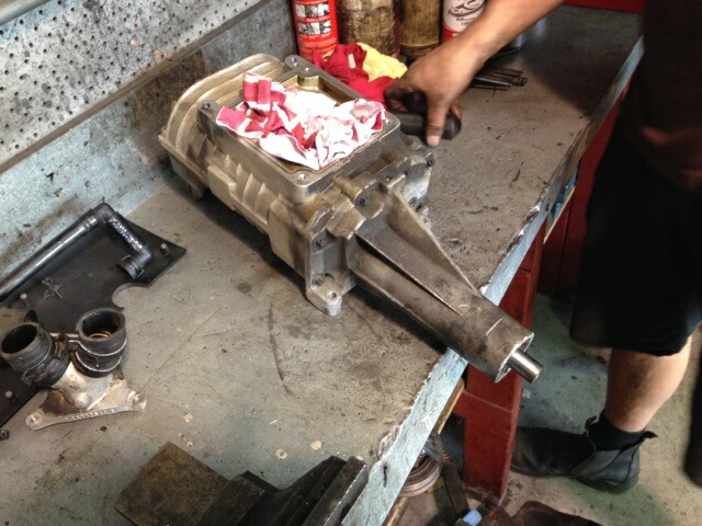

Hi Guys. Finally got the top super charger pulley fitted. I bought it from Powerhouse Automotive in UK. Its the 10% increase one. Should give 2.5-3 psi increase and approx. 35-40bhp. I will verify this when I get the Dyno done in a couple of weeks. I have uploaded the pix as best as I could. We decided to remove the super charger to grind the snout more accurately. Gives a proper finish. The scariest part of the job was heating the pulley to fit the super charger. I have to say I can definitely feel a difference in throttle response. Much more eager and aggressive. Its only been day 2. So need a little more time to fully test it out. When I get the 2nd dyno done I will post the comparisons and see just how much of an improvement this mod has achieved.

Hi Muncher, I got the same pulley from PH UK. I hate to break it to you but my test was b/4 and after 1/4 miles and they were practically identical. The power gain your feeling is actually the boost spooling up sooner with the smaller pulley. I believe the only way to get the full benefits is with an ECU tune (my next mod). I'll be going with the Viezu pulley and exhaust tune since I also have Milltek HFCs.
BOL
PS I'm amazed you got the Supercharger out, I did mine right on the car b/c it seemed there was a nut on the underside I couldn't get undone.
