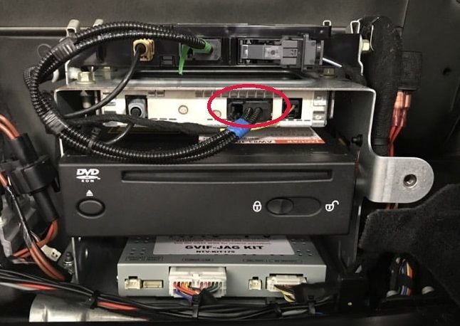

FINALLY !!! I purchased a replacement Tesla style head unit and performed the install with the same results of no sound initially. I finally tracked the reason to the signal processor in the trunk. I added an additional optical loop to the cable entering the lower unit and voila!! Got the factory interface, Apple Carplay if I want it, and added the CarWebGuru startup screen. I'm currently using my iphone as a wifi hotspot but will soon have a sim card with a data only plan so my system just WORKS no matter what phone I have. I'm also planning to replace the speakers with more full and responsive gear, and addressing a few additional repairs (minor oil and coolant leaks). Pictures before the end of the year!
Thank you all very much for your thoughtful suggestions and encouragement.
Can you be more specific please? Pictures of where you added the loop and an understanding of which “blue box” you have. Thanks.

I'm running the original optical processor that came with the headunit. The XF box is wasted money for me.
Below is where I placed the loop.
