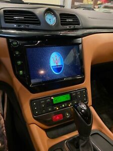

Really want to do this- if they just had a more normal looking screen. My XK isn't a Tesla and I don't want it to be. But a more modern OEM looking screen would be nice.
AuCar for Maserati is perfect

Yeah, I'd MUCH rather have physical buttons for commons stuff like radio and climate.
Sorry if I hijack, but this is what I would look for. I want to keep physical buttons and good old CDs, but would like as big a nav screen as possible. Any threads on such a solution?
