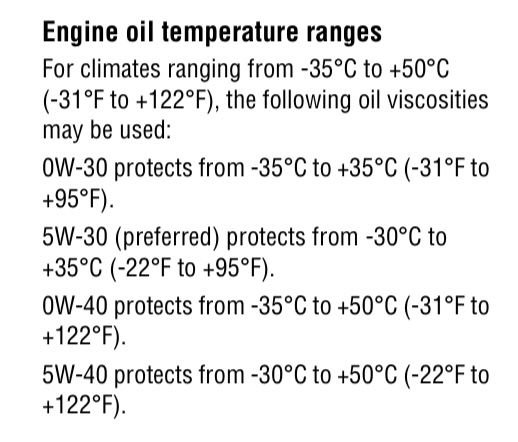

kj07xk
close
- Join DateJan 2015
- LocationNaperville, Illinois USA
- Posts:5,314
Likes:3,821
Liked:2,587 Times in 1,700 Posts
Also from the manual.
