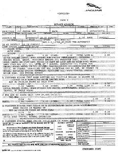

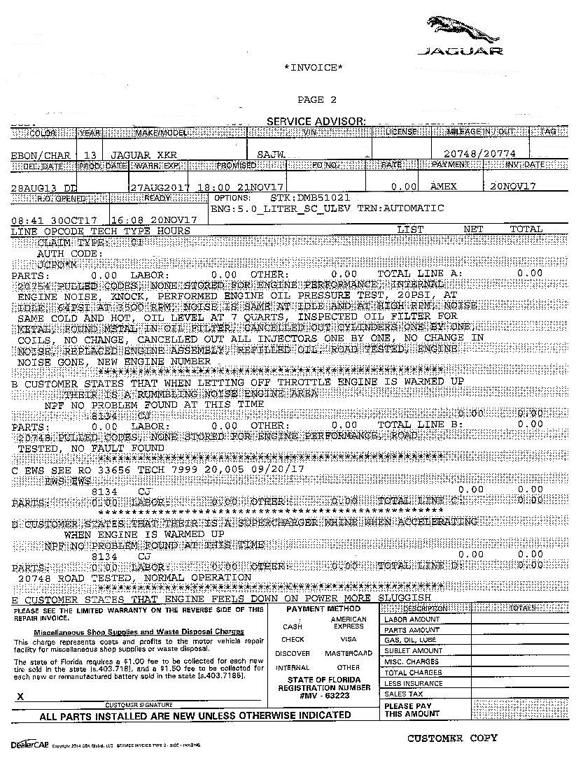

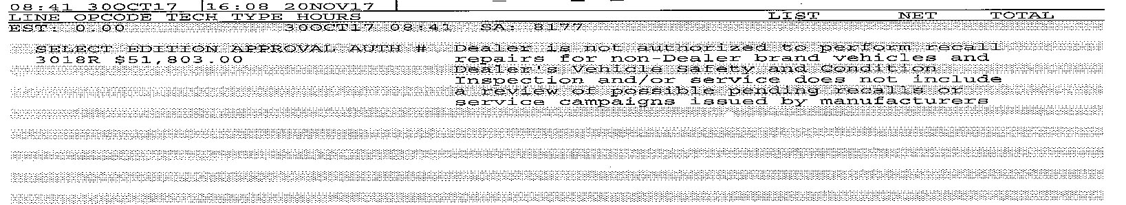

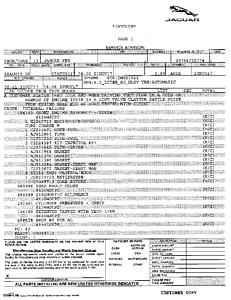

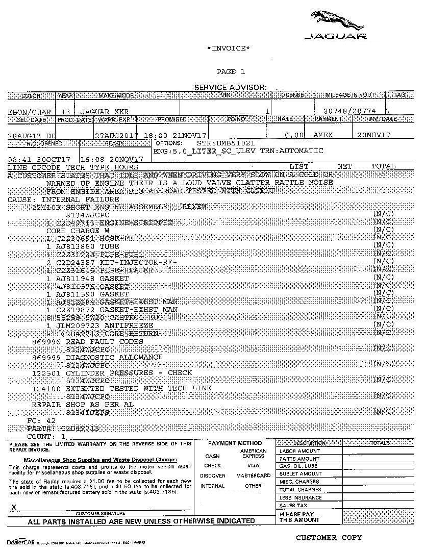

The R is back. Observations on a zero mile engine: no ticking, much more linear pull.
The service sheets are as much as I know.
Attached Thumbnails Tick tick tick...-1.jpg   Tick tick tick...-2.jpg   Tick tick tick...-3.jpg
